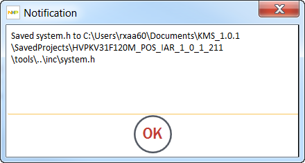

First for 48 VBus Max the the nominal Vbus would be lower allowing some headroom for regenerative braking voltage or transients. The nominal 24 V system is set up for a 36 V DC bus maximum with a 30V Overvoltage setting in KMS. So for a nominal 48 V we must push the circuit to it's maximum of 58V based on the Maximum specification of the pre-driver.   For 58V max R74  must be 49.7K Ohms- if you are leaving R77 and R79 alone = 1.5K

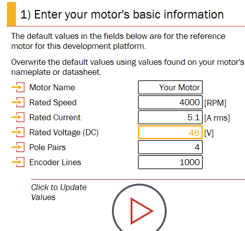

Then in the KMS wizard set the Maximum DC bus = 58V and the overvoltage to 54 or 53 V, under voltage appropriately for your circuit.

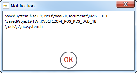

The error you are getting is there because you tried to change both the Maximum and the Over voltage at the same time.  If you do this in steps, first changing the max DC bus, storing these parameters, then changing the Overvoltage value you don't get the GUI error flagged but get this.
Then you can go back and enter the basic motor information and hit the play button to store the information.

I really appreciate the detailed response. I went through your process of updating the Maximum DC Bus > Saving > Over/Under Voltage > Saving > Basic Motor Information and I no longer get the ADC offset and Current monitor faults but I keep getting the DC Bus Over-voltage when I try to start the Automatic Parameter Measurement. When I go back to the Protection and Hardware tab, the Over and Under Voltage fields are back to their default values (37.5V, 22.5V) even though I updated the motor drive configuration and stored the motor information. Any idea on what may be going on here?

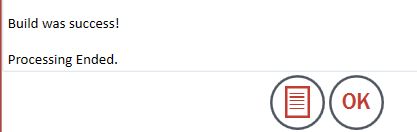

I have noticed on this version of KMS that when doing Trajectory testing and changing the parameters, that when I save the parameters to the system.h file, the defaults keep coming back.  This is a known issue with KMS, and I'm not sure about the work-around.  It may be that you have found another of these issues but let's see if my idea below fixes your issue.
The values that are written to the MCU when you "Save" it is written to RAM, a structure that is loaded from flash at reset and then the system.h file.  So it's understandable that if you don't re-compile the new values in the system.h file the defaults won't be in the project on the MCU.  In this message it is telling you that it is saved.
So to make that happen there is an option under the KMS GUI to run project on MCU. Or you can use your IDE, build the project and download with the debug interface.
In the GUI Select PROJECT TAB --> RUN PROJECT ON MCU (CTRL - R)
and the build of the project will happen and hopefull you get no errors or warnings and the build is successful.
It will then download the new image to the MCU.
Philip

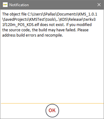

The build procedure did come back with an error saying that the twrkv31f120m_POS_KDS.elf does not exist so I was unable to test your work around.

You need to open your project in the IDE , either KDS or IAR and fix the compile errors.
