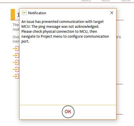

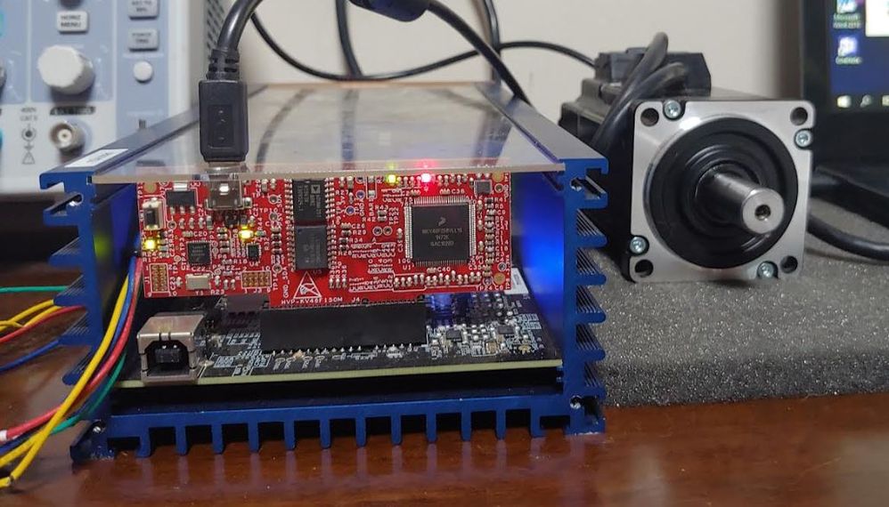

I'm using HVP-KV46F150M daughter board to study motor control and
I wan't to run PMSM motor under Kinetis Motor Suite.
According to KMS Lab Guide, I installed all the necessary programs,
but I can't communicate with the MCU even though I had bought a new version
of HVP-KV46F150M daughter board which is KMS enabled(ACIM) version.
Below is error message.
Could someone help me?

Have you tried to use the USB connection at the front of the unit?

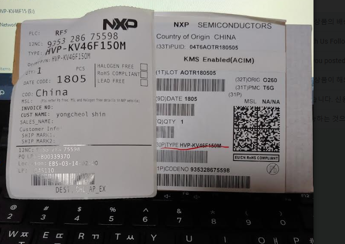

Also when and where did you buy the HVP KV46 card?

I tried to connect through USB, but error message is same as above picture.
I bought HVP HKV46 CARD at NXP web page about one month ago,
and this card is KMS enabled version as the below image.

The front USB is what is used for the KV46 HVP board for KMS as noted in the Users Guide.
