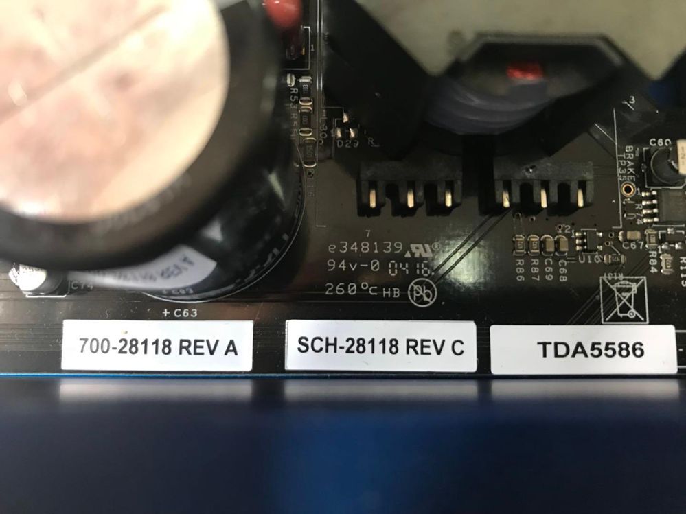

Eval board information, don't know if it's useful to you.
Hi,Adam Reynolds
   This is the case, I understand. It seems impossible to get a detailed process of the code. thank you.
