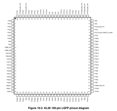

but the board frdm-kl26z have 64 pins but the processor mkl26z256vll4 i have has 100 pins.
the processor mkl26z256vll4 is not packed in the board.it is stand  alone i mean you can pluged in and out the processor from the board. i think it is specificaly designed for nxp car competition.the car model is alamak. i am using frdm-kl46z  instead.
my question is i could burn a code to the processor but i couldnot control a servo motor or control an led .

I suggest that you refer to the Reference Manual of the mkl26z256vll4 to modify the code. And you can use the MCUXPresso config tools.

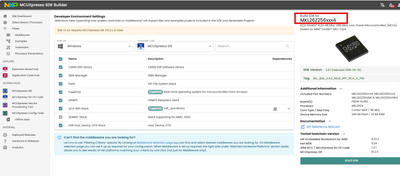

I wasn't able to find any information about the kl26p100 board on the official website. Maybe it's a custom board.
For mkl26z256vll4 mcu, you can use our FRDM-KL26Z, it has the SDK and many resourses and documentation.
FRDM-KL26Z|Freedom Development Platform|Kinetis® MCU | NXP Semiconductors
The SDK for the mkl26z256vll4 processor is also provided, and you can use it as well.
Hope it can help you.
