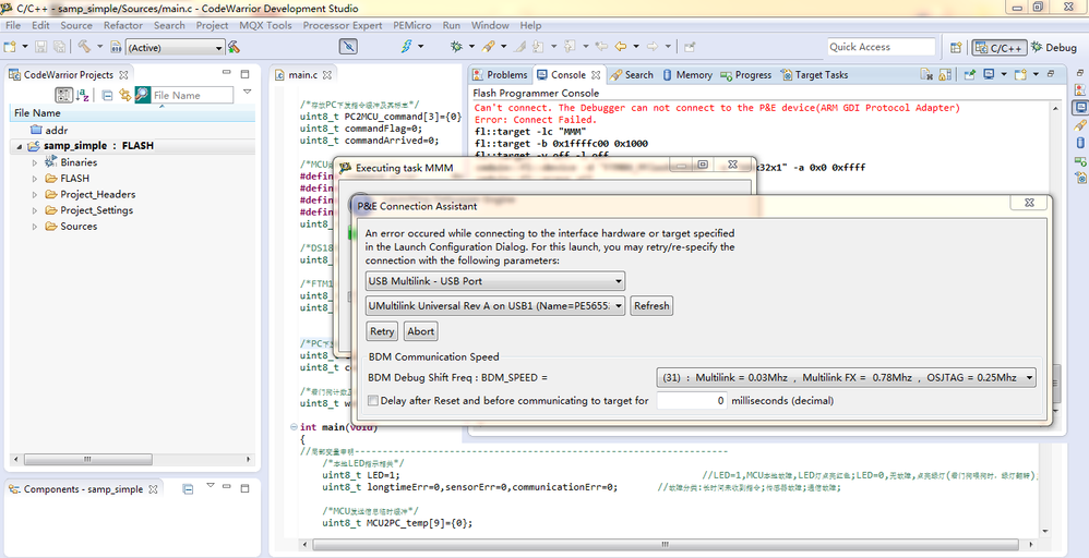

thank you for your response. i have followed the references you give. but there still exists a trouble, my CW10.6 can not connect to the P&E device(this error exists all the time ). the error i get was:
the debug configuration i set was shown as follows:
and the JTAG connector i adopted was:
p.s. there is no pull-up resister in SWD_DIO pin. Actually, i have tried to add one, but it didn't work.
p.p.s. the pull-up resister in RESET pin has been replaced by a 10kΩ one, and the capacitor has been taken off.
p.p.p.s.  the codes can been loaded to another board(freesacle's FRDM-KE02Z) with the same P&E multilink universal.

and if i connect my board to CW10.6 by P&E multilink universal ,  the CW report disconnecting error,
of course, only the USB LED the on PE  multilink universal illumines ,the TGTPWR LED on PE did not illumine.
how can i do to handle with my trouble?

Jorge_Gonzalez
Hello MA QINDONG:
Your last comment:
That is not good. Both LEDs have to be ON. Check that the TVCC pin of the JTAG/SWD connector is connected to VCC. And in general check that the MCU is properly powered (VCC and GND pins connected).

maqindong
DONE!!!  thank you for your advice! i checked my board carefully, yes, it's empty solder. after amending this mistake, i succeeded to erase the virgin MCU.
p.s. i succeeded with no pull-up in SWD_DIO and no pull-down in SWD_CLK. if i added these two resistors, i failed. i didn't know the reason. anyhow, i can program the MCU now.
at last, i am very grateful to all those helped me!
