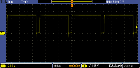

I have a minimum system with the Freescale KE02Z64 MCU,and there are just three parts--power supply circuit, reset circuit and crystal oscillator  in this system. then i try to load code to the MCU with the JTAG interface using PE multilink universal. but I failed. the problem is that the signal of restet pin is as follow,TEK00000.PNG
P.S. the power is +5V.
p.p.s. the MCU is newly-welded,no codes in it. it's the first time to use the MCU.
p.p.p.s.the reset circuit and clock circuit are as follow.
how should i deal with this problem? i am needling your help?

On a blank device, all of the flash memory sits at the erased state 0xFF (except address 0x0000_040C FSEC which is 0xFE).
You fit the device to your board, and apply power, then core goes to 0x0000_0000 to fetch the initial stack pointer and 0x0000_0004 to fetch the reset vector. Both of these read 0xFFFF-FFFF and so these are illegal addresses. This causes the chip resets, and starts all over again.
The symptom is that the reset line oscillates as the chip runs (reset high) then resets (reset low). It's not unexpected.

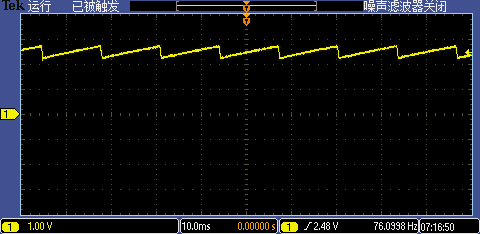

Yong Li,thank you for your advice. i have referred to the material you send me. and i have checked my custom board carefully. but i have not found any solutions. here i list my board's routing.
1, all the VDDs including Pin 6 of the MCU(U2) have connected to VCC(+5V) .  all VSSes including Pin 7 &Pin 8 have connected to GND. all of these pins have tested.
2, SWD_CLK and SWD_DIO connect directly to P1. p.s. the Temp4 which share with SWD_CLK has been taken off.  both SWD_CLK and SWD_DIO  connect no external pull-up/down resistors.   actually,  i have tried to add a 10kΩ pull-up resistor to SWD_DIO and a 10kΩ pull-down  resistor to SWD_CLK, but i didn't work.
3, the reset pin of U2 connects to a 10kΩ pull-up resistor without capacitor.
4, other pins except for mentioned above were suspended.
in this condition, i got the signal of MCU's reset pin was:
is it reasonable? it seems to be different from https://community.freescale.com/docs/DOC-99609 .

maqindong
DONE!!!  thank you for your advice! i checked my board carefully, yes, it's empty solder. after amending this mistake, i succeeded to erase the virgin MCU.
p.s. i succeeded with no pull-up in SWD_DIO and no pull-down in SWD_CLK. if i added these two resistors, i failed. i didn't know the reason. anyhow, i can program the MCU now.
