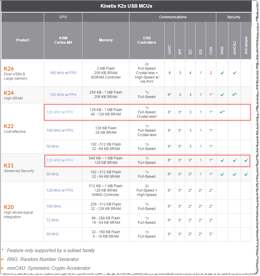

what is the difference between TWR k21 F120 MA and TWR K22 F120MA tower boards

The main differences between K21 120MHz and K22 120MHz are as follows::
The TWR-K21F120MA using MK21FN1M0AVMC12.
The TWR-K22F120M using MK22FN512VDC12.
The detail differences between MK21FN1M0AVMC12 and MK22FN512VDC12 can be found in attached NXPProductSelectorResults.
Robin
