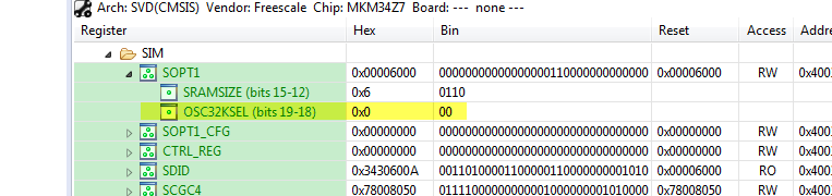

I tried in a different way - but this was the problem:

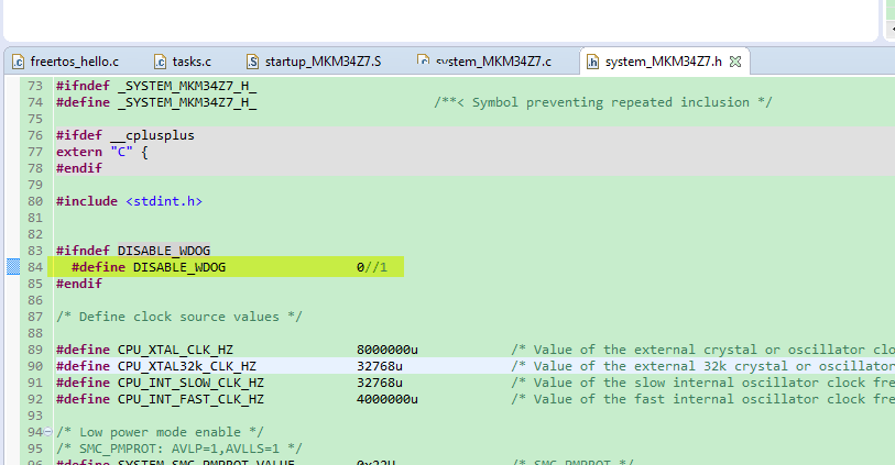

* In system_MKM34Z7.h the DISABLE_WDOG was really defined to 1. But for the reason, that my code don't booted after changing to zero, I decide to initialize the Watchdog in sytem_MKM34z7.c in function SystemInit.
I do initialize the watchdog in this position like I want to use, but with cleared WDOGEN - for the reason, that I do not use the watchdog in every case.
* I setted SIM_SOPT1 bit 18 and 19 to 1, before I initialize the Watchdog for using.

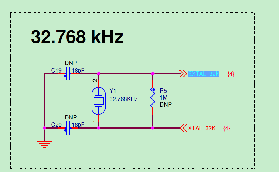

Background: On my own PCB is no external XTAL mounted
So it works fine.
It looks like:
1. the watchdog must be initialized very early in code first time (regardles of using or not)
2. SIM_SOPT1 18&19 must configured for delivering a clock before the Watchdog is be initialized to use and regardless if the LPO or ALT clock is used in WDOG_STCTRLH .
Thank you for the hints!

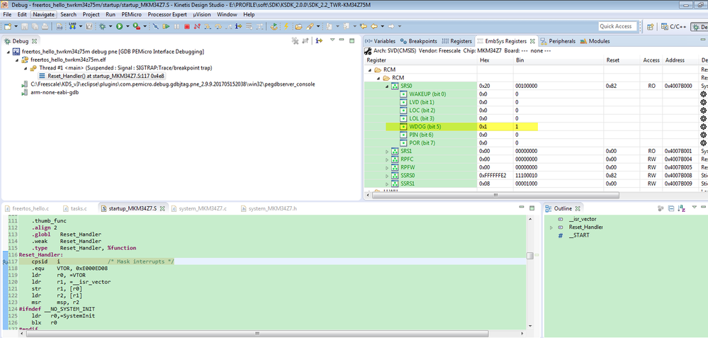

   I already test the KSDK2.2-TWR-KM34Z75M freertos code about the watchdog,  the watchdog works on my side.
   Now, let's use the same code, and follow my way to test it:
1. Download the newest ksdk sample code for KM34 chip.
  Welcome to MCUXpresso | MCUXpresso Config Tools
SDK Builder, choose the board as TWR-KM34Z75M, then generate the code and download it.
2. Open the freertos code, the code path which I used is : SDK_2.2_TWR-KM34Z75M\boards\twrkm34z75m\rtos_examples\freertos_hello\kds
3. modify the code
1) don't disable the watchdog after reset
   system_MKM34Z7.h, line 84, define disable_wdog as 0.
  2) Run the code, you will find it always in the reset handler

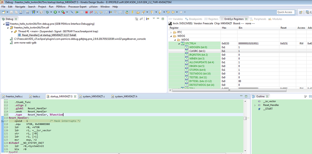

   Check the register:
   You can find the RCM_SRS0[WDOG] =1, it means the reset is caused by the watchdog, so the watchdog works.
You can follow my steps and test the ksdk2.2 freertos code in the twr-km34z75m board at first, after it works, you can test it on your own board.

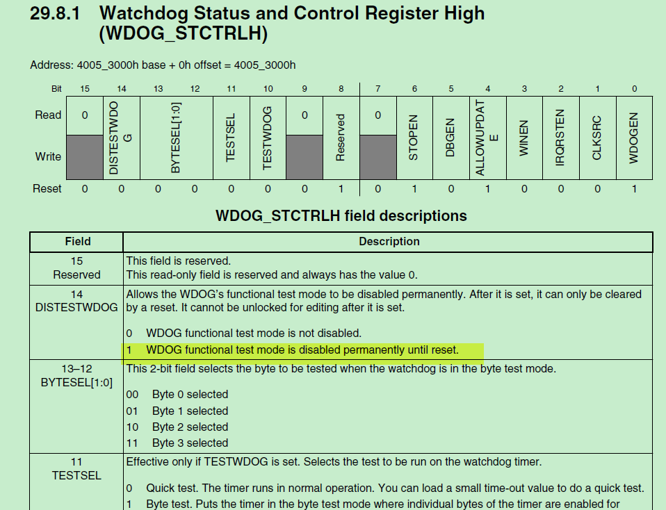

The value of the WDOG_STCTRLH register is: 0100000000110011 - so I would think, the WDOGEN is enabled.

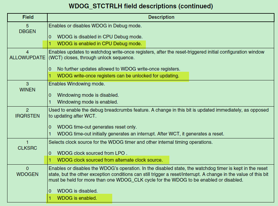

Your clock is using the alt clock,
You need to check the according clock source, whether you have the clock?
I think you can configure it to use LPO directly, because LPO is alway enabled.
free RTO is no relationship with the watchdog, please check your watchdog clock source.
