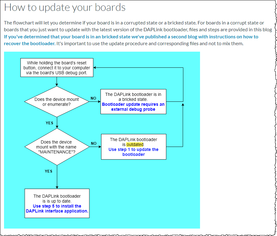

the getting started guide (https://www.nxp.com/document/guide/get-started-with-the-frdm-k64f:NGS-FRDM-K64F) has a pop-up warning about windows 10 issues with older versions of the OpenSDA firmware....  here are the critical steps which still didn't work on my FRDM-K64F board:

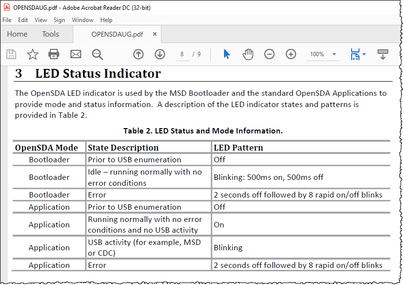

my board enumerated as BOOTLOADER (which indicates an older firmware version), so i followed step #7 above....  after copying this .bin file, the led next to the USB connector started blinking faster (2-3 Hz); previously, it was blinking at 1 Hz which is typical of "bootloader mode"....  more important, the board did NOT automatically re-enumerate as MAINTENANCE....  re-inserting the board with the reset button pressed caused to board to (again!!!) enumerate as BOOTLOADER....
before i try loading the K2x directly through Jlink, perhaps someone could suggest an alternative here....  i do recall getting my first (now broken) FRDM-K64F board to actually enumerate correctly -- though MCUxpresso complained when it tried to load an image....
suggestions on how to proceed???
Check if it's Bootloader error state.

Please follow the DAPLink bootloader update.
If still enumerate as BOOTLOADER, try to program a simple demo into K64 using external debugger connect to J9. The reset signal from K64 may push the OpenSDA enter bootloader mode.
