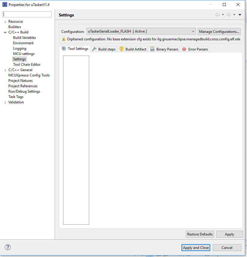

I Imported Open source version of uTaskerV1.4 to MCUXpresso IDE v11.0 following one of your video on YouTube Channel
https://www.youtube.com/watch?v=K8ScSgpgQ6M&index=9&list=PLWKlVb_MqDQFZAulrUywU30v869JBYi9Q
but  i am not able to build it.
below is the message i got in the console
**** Build of configuration uTaskerSerialLoader_FLASH for project uTaskerV1.4 ****
Nothing to build for project uTaskerV1.4
also in project properties
Orphaned configuration. No base extension cfg exists for ilg.gnuarmeclipse.managedbuild.cross.config.elf.release.1518097371.1707471076.737691589.420265764
T
Thank You
2,335 Views
mjbcswitzerland
Specialist V
I think that you have missed the initial step (when choosing the Eclipse based IDE) of copying the project to the root directory (or you copied the KDS one instead of the MCUXpresso one).
You need to copy the content of
\Applications\uTaskerV1.4\MCUXpresso\Project_Settings
to the root directory (that is, where you find the directories "Applications", "Hardware", "stack", "Tools", "uTasker")
Then import the project again and it should be OK (you possibly imported a KDS configuration to MCUXpressor by mistake).
