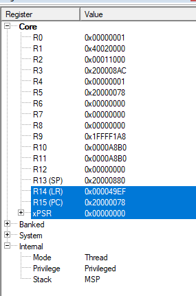

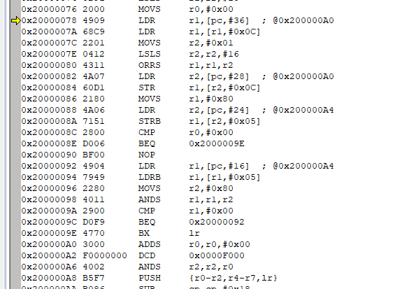

I run code on RAM, it crashes into hardfault interrupt. I using SKEAZ1284
the first picture is code on flash. the second picture is the code run on RAM, but when it executes at 0x20000078 hardfault interrupt occurs. it just normal instruct read theMCR->PLACR register address into R1

  Could you tell me what the IDE you are using, do you just put the FLASH_LaunchCMD to RAM or the whole project to RAM.

thanks for your suggestion, I am using keil, first I place FLASH_LaunchCMD on code section, compile the code.then copy the code data into a data array, use a function pointer jump to data array execute FLASH_LaunchCMD.

     When do the flash operation, especially launch the command in the RAM, customer need to disable the global interrupt at first, after the command is finished, you can enable the interrupt again.
   Do you disable the interrupt?
__disable_irq();
Launch flash command;
__enable_irq();
