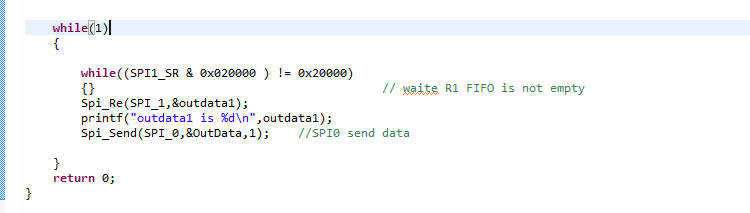

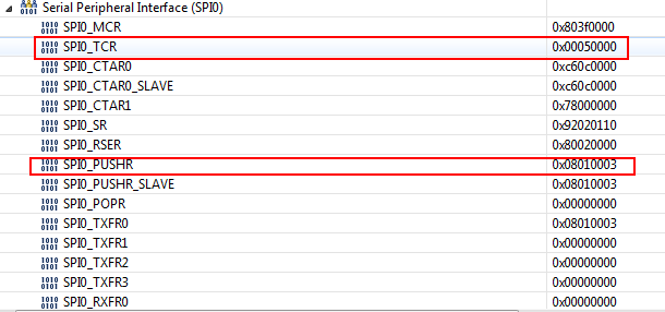

Fan_xy
Hello
I use TWR-K60D100M   spi0 is master , spi1 is slave ,  sip0 send "3" to spi1 ,  In the scope I can see the correct signal and clk singnal .
And I also can see the transfer count register " SPI1_TCR" work increase ,
And in the spi1 , I can see the spi1_sr_tcf  setting to 1, also spi1 can enter the receiving interrupt .
While in the FIFO register "SPI1_POPR" is always 0.  I don.t know why ?
Thank you !

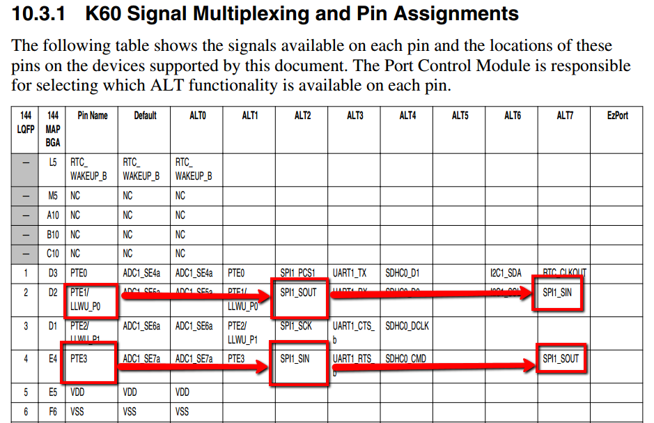

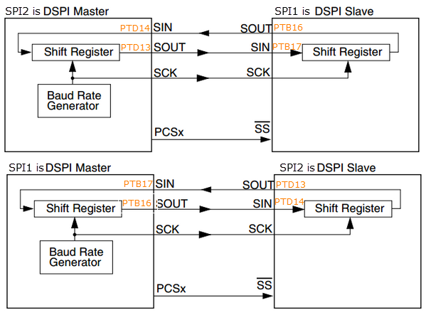

santiago_lopez
Hi Linda,
Did you check the pin muxing for the pin you are using for SPI1 SIN? Check the PORTx_PCRn register to make sure that the PORT_PCR_MUX bit field is configured properly (check Reference Manual Chapter 10.3.1 for pin muxing information)
Also please check that you have connected the Master SIN, SOUT pins to the correct SIN,SOUT pins in the slave according with the diagram on reference manual chapter 50.4

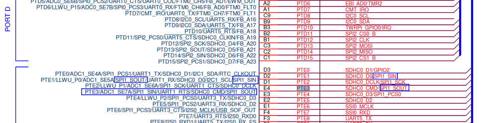

Fan_xy
Hi Saludos
Thank ! You are right , I the PTE3 is the SPI1_IN.   I config the SPI pin refer to the board sch , I haven't see the chapter 50.4 .
So,  now I confused about the reference manual 50.4 and the SCH of TWR-K60D10M , they are inconsistent in my understanding . pleas help me again , thank you !

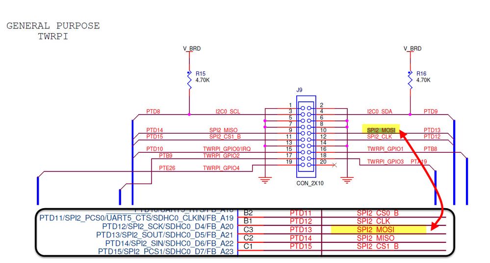

While ,I  still have some confused about the SCH of TWR-K60D100M ,  for example ,
the pin PTD13 is SPI2 MOSI ,it is mean  if SPI2 is master , PTD13 is out pin , if  slave , ptd13 is in  .  while from the sch,  this pin only can used to SOUT  , is this mean  spi2 only can used to master ?
Or I misunderstand somothing?  please tell me  .

adriancano
Hi Linda,
As my colleague Santiago mentioned you need to check always you are connecting the correct SPIx_SIN (MISO) pin on the master side to the SPIx_SOUT (MOSI) pin on the slave side and also the SPIx_SOUT (MOSI) pin on the master side to the SPIx_SIN (MISO) pin on the slave side. In the image below you can see a configuration example that show SPI2 as master and as slave.
I hope this information can help you.
Adrian

Fan_xy
I know your meaning , I know the meaning of MISO  and the MOSI , I also know the  image you give me .
My qustion is the  SCH of TWR-K60D100M (from freescale ) .  According to the truth , SPI 2 can as MASTER  ,also can as slave , while from the SCH,  whether said  the spi2 only can as master on the TWR-K60D100M board ?

adriancano
Sorry, I misunderstood your question. I see where the confusion is.
The SPI2 can be used as master or as slave as I indicated in my last response. But, when a device is connected on the TWRPI connector the PTD13 is the SPI2_MOSI that is why you can see in the label SPI2_MOSI. The label there is for the TWRPI connection that you can see in the schematic.
In conclusion if you connect a Slave device on the TWRPI connector the SPI2 just can be MASTER but if you are using the PTA13 pin in your own hardware connections SPI2 can operate as Salve or as a Master.
