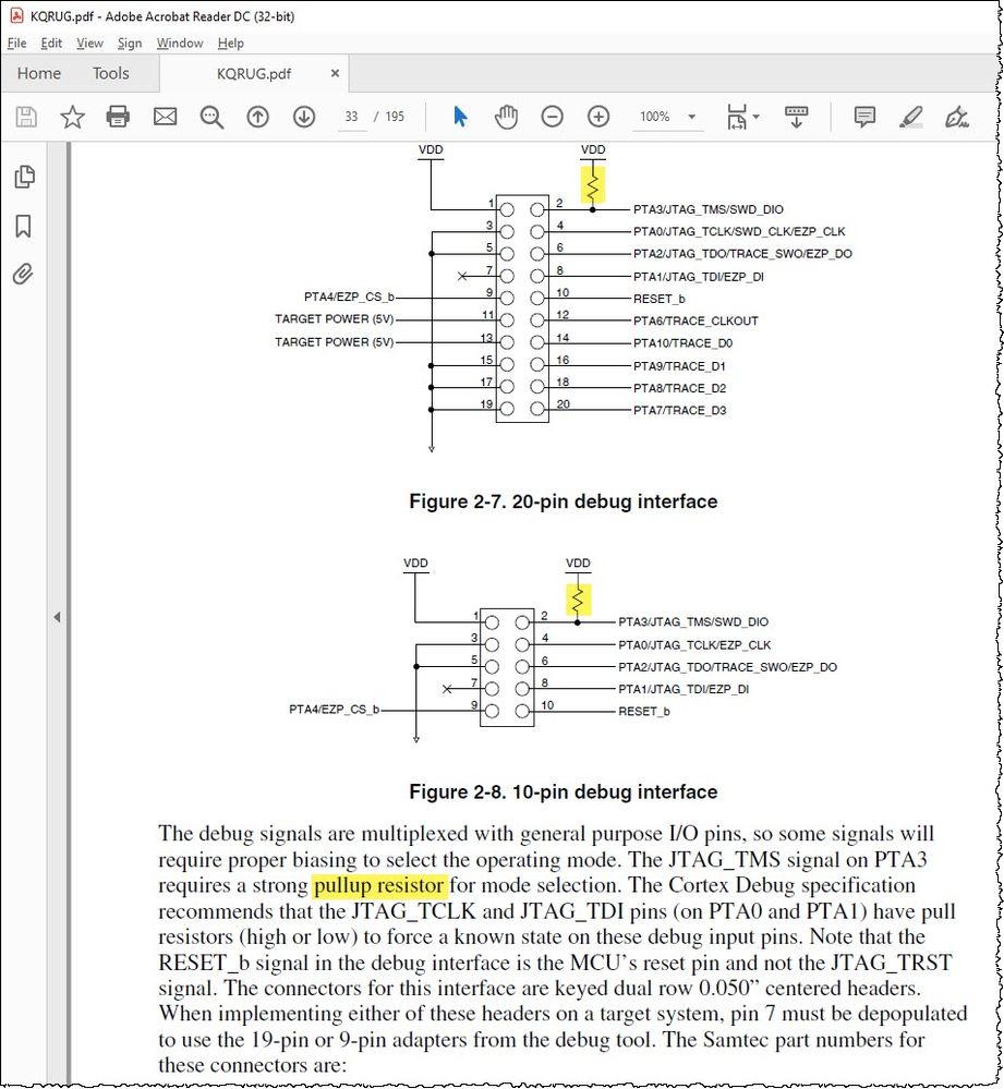

Please check the hardware by refer: KQRUG, Kinetis K Quick Reference User Guide
1. RESET_b and NMI_b
2. Debug interface

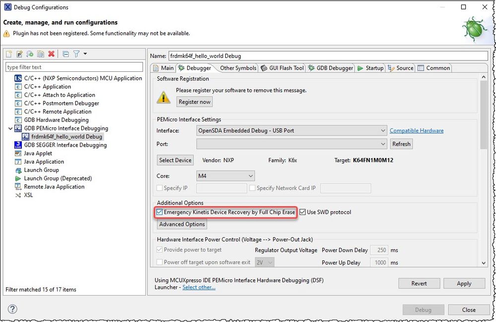

Since you are using MCUXpresso IDE, then you can check the "Emergency Kinetis Device Recovery by Full Chip Erase".
If still not work, then you may need to use the Kinetis_Recovery_Utility by refer: Recovering Cortex-M Microcontroller with a Power Glitch
