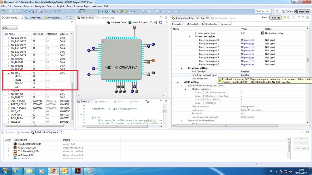

I didn´t program the 0x40C address related to "NV_SEC" because I´ve only done the tutorial from Processor Expert, but I don´t know if this application program this address (0x40C) by default when I choose "Generate Processor Expert Code".
Anyway I tell you that it appears in this this address in my application:
NV_SEC (Address: 0x40C):
Init. value. 7E
After reset. FF
whose bits are:
KEYEN bits:
Init. value. 01
After reset. 11
MEEN bits:
Init. value. 11
After reset. 11
FSLACC bits:
Init. value. 11
After reset. 11
SEC bits:
Init. value. 10
After reset. 11
I don´t know how I can access to these registers by the "Processor Expert Application".
I would like to know how I could erase the firmware loaded in the MK20DX64VLH7 microcontroller to be able to reprogram it, as well as reprogramming in unsecure mode in order not to have this problems again. Or to program a firmware erasing the firmware loaded before. Do you know if there are any application to manage this. I have used "pe_gdb_server" and "multilink_universal" applications before but without any success.
Moreover I didn´t check a box to secure. The security boxes from the flash are disable by default and Protection regions are unprotected in Component Inspector Properties in  the "Processor Expert Application" in KDS.
According to this I think there shouldn´t be any problem with accesses related to security.

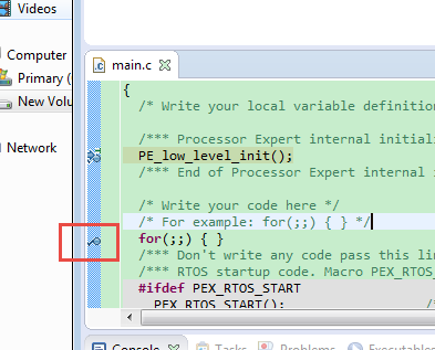

kerryzhou
Hi Arturo Arteaga,
Please enter the debug mode at first, then put the break point.
 Don't put too much break points.If you still not OK, please give me some pictures from your side, I will help you to investigate it.
Kerry

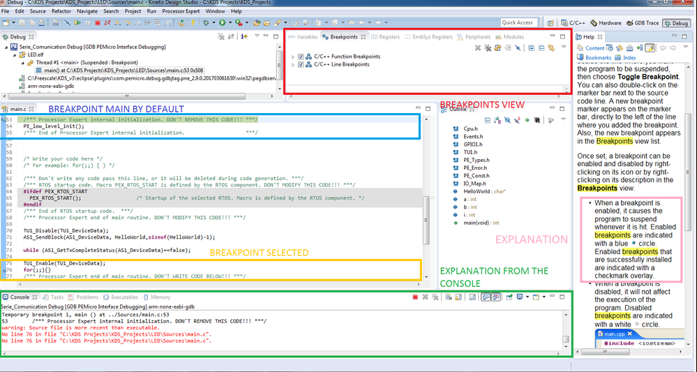

arturoarteaga
Hi kerry,
Hi Kerry again,
I haven’t managed to get tick signs again. After debugging I have put the breakpoint in the left side of one line the code, however I have only one blue circle. I send you two captured images. One it´s from the “Debug configuration” (Breakpoints GDB Multilink_Universal image), where you can find in the bottom from “Startup” tab something related on debugging step by step, and my dude it´s if I have to modify this default configuration. Another image is Debug perspective View (Debug_Breakpoints image), where I show you breakpoints view (red rectangle), the breakpoint by default in main file (blue rectangle), the breakpoint that I’ve chosen (orange rectangle), explanation from the help that it’s mentioned about checkmark overlay (pink rectangle), and in the bottom console explanation after debugging that you can read about breakpoints (green rectangle).
For more information for you, I have managed to debug with another board, with the FRDM-KL25Z board with OpenSDA and I haven’t any problem to see the breakpoints with tick signs in the left side of the code from the beginning. For this reason I think perhaps I need some kind of plugin because I actually I’m debugging with Multilink Universal with my actual board with MK20dx256vlh7 microcontroller.
I hope this serve you to find the solution. Thanks a lot for your help.

4,018件の閲覧回数
kerryzhou
Hi Arturo Arteaga,
   What the KDS version you are using?
  If your version is below KDS3.2, please download the newest version and try again:
Kinetis® Design Studio Integrated Development Environment (IDE)|NXP
  If your anther board can use the breakpoints, please check you code, make sure the break point position can be executed.
Kerry

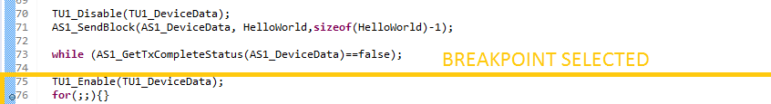

kerryzhou
Hi Arturo Arteaga,
    You post this picture before:
Please write these code
before
You add break point in for{;;}, are you sure your while(AS1_GetTxCompleteStatur(..)==false) is executed?
I just want to make sure your code is not blocking before your break points.
Kerry
3,994件の閲覧回数
arturoarteaga
Hi Kerry,
I managed to see breakpoints. I have had to reinstall the application and I have had to make some updates in the application.
