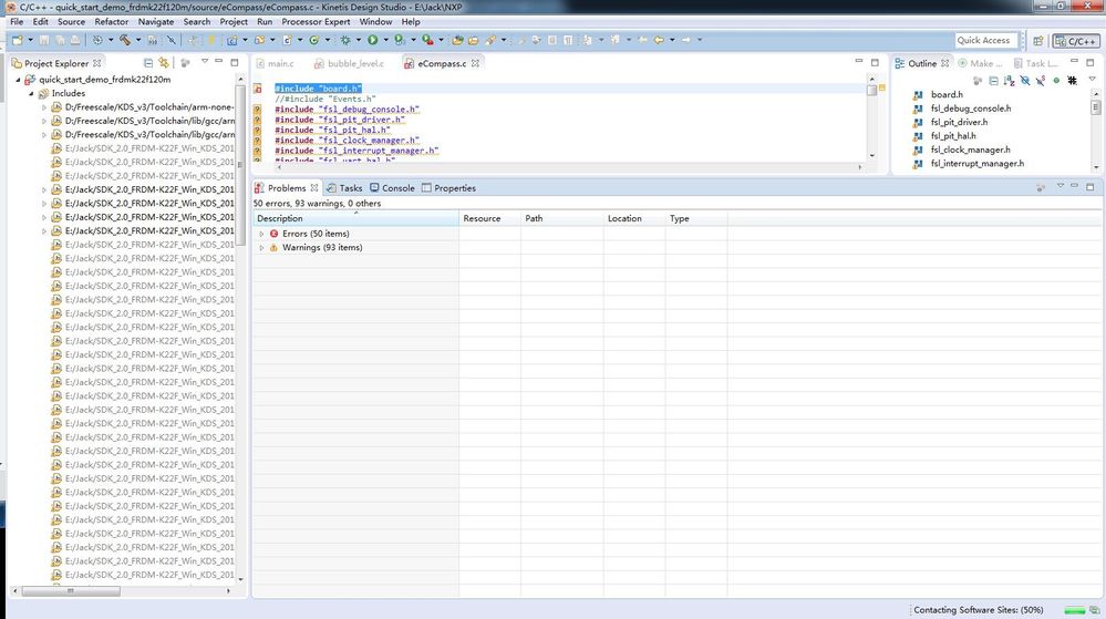

Hi there,
After download FRDM-K22F-QSP Quick Start Package, i imported the project into KDS. After building the project, there is many errors and warnings.
     Thanks in advance!
     Jack!

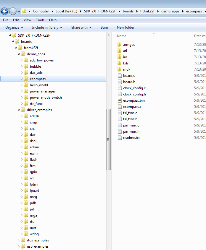

Hi Jack,
You can read the reply from Adrian Sanchez Cano in Compiling Quick Start Package for K22F Freedom Board With KDS 2.0.0 and KSDK 1.1.0. That was the reason why you get so many errors and warnings.
I recommand you use the examples in KSDK2.0. (If you have not used it, please read Introducing Kinetis SDK v2 first.)
You can download and install it refer the methods in How to: install KSDK 2.0.
Robin
