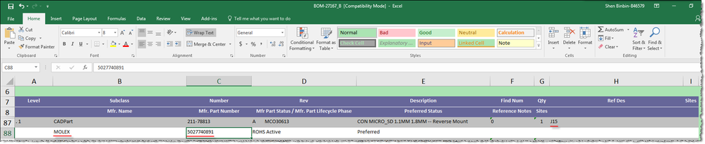

Hello everybody,
Does anybody know the part number of the micro SD card slot on the TWR-k60F120M schematic.
We would like to use the same in our projects.
Also ,
Wat can be the maximum lenght of the PCB tracks from the controller to the SD card.
Thanks in advance :smileyhappy:
Arun

Hi Arun,
After download the TWR-K60F120M Design Package, you can find the BOM-27167_B(Bill of Materials).
This microSD Card socket is available on Molex.
Robin
