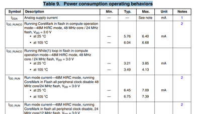

I have find there is no MKL36Z256 option for the power consumption eastimation tool, only MKL33Z256 available.
Please tell me how to solve this issue or should they shared the same power consumption under KL3xx family?
1 返信
507件の閲覧回数
Celeste_Liu
Hello @5874967FEF ,
Thanks for your post. The KL33 and KL36 are not from the same die, so their power consumption should be different. You can check "Table 9. Power consumption operating behaviors" in their datasheets. It can be seen that KL33 performs better in terms of power consumption.
KL33: Kinetis KL33: 48MHz Cortex-M0+ 128/256KB Flash (64pin)
KL36: Kinetis KL36: 48MHz Cortex-M0+ 64-256KB Flash 64-121pin
As for the power consumption eastimation tool, it is an old tool developed by Freescale and is no longer maintained. Therefore, I am afraid it is not possible to add support for KL36. Sorry for the inconvenience.
