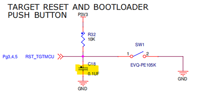

Celeste_Liu
Hello @MaxWood ,
Thanks for your post. The standard practice for the RESET Pin is to use a 0.1uF cap along with a 10K pull-up resistor. Just like the following picture.
Please try again to see if the problem will still occur after adding the cap.

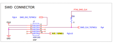

Celeste_Liu
And please double check your schematic about SWD part. I have doubts about the two yellow marked parts below and think they need to be modified. First, the RESET_pin should not be connected to pin1 of the SWD. Second, pin9 of the SWD should not be grounded.
You can refer to the schematic of our FRDM-KE04. The schematic will be attached.

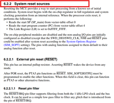

Celeste_Liu
Hello @MaxWood ,
I'm sorry to hear that. You mean that abnormal resets occur without pressing the reset pin. Does this happen after power  on or during program execution? If it occurs during program execution, it might be a software issue. Please refer to section "6.2.2 System reset sources" in the RM, and check them one by one(from 6.2.2.1 External pin reset (RESET) to 6.2.2.8 MDM-AP system reset request).
Hope it can help you.
