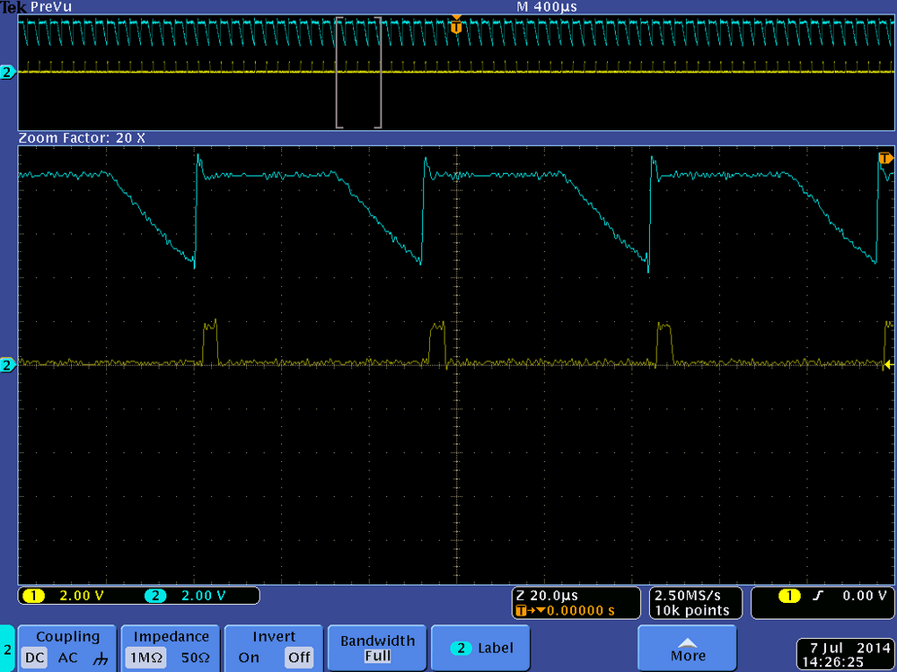

Consider the above image.
The blue is the PWM. At each interrupt of the TPM0 I am making a pin high and low(the yellow pin).
TPM0_C0SC |= 0x28;
TPM0_C2SC |= 0x28;
TPM0_C4SC |= 0x28;
The code is for " Edge-aligned PWM High-true pulses (clear Output on match, set Output on reload)"
This is as per the datasheet and correct to my understanding. But the yellow toggle is done done properly. It
should rather be done at the end of the PWM on (so its a delay of 25uSecs). How is this so.

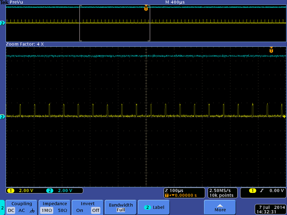

But, in case I change the code to
TPM0_C0SC |= 0x24;
TPM0_C2SC |= 0x24;
TPM0_C4SC |= 0x24;
I get the following image. The PWM never has a low period. Though it does do the interrupt action . Pls see the image below.
The blue is always high. The yellow (diagnostic) is manipulated in the ISR as expected. Strange behavior :smileyhappy:
