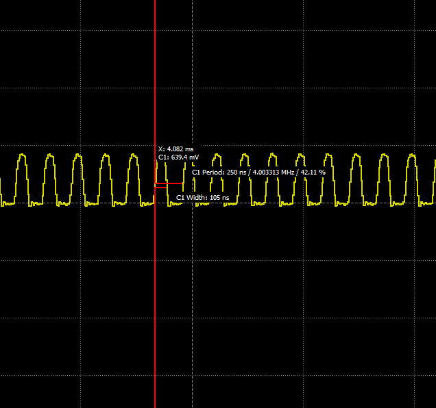

I am trying to output 4MHz and 50% dutycycle on KW36. I run the demo frdmkw36_driver_examples_tpm_simple_pwm and I make some modifications:

but I get this:
This is not 50% dutycycle. How could I get 50% dutycycle pwm?

Hi Mo Xinyu, I hope you're doing well!
Unfortunately, it's not recommended to generate PWM signals of high frequencies such as 4MHz, as they tend to get really deformed because of the physical capabilities of the board, and they don't tend to work as well as a lower frequency PWM signal.
I'm sorry for the inconveniences this may cause.

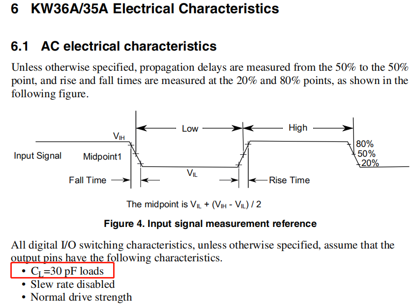

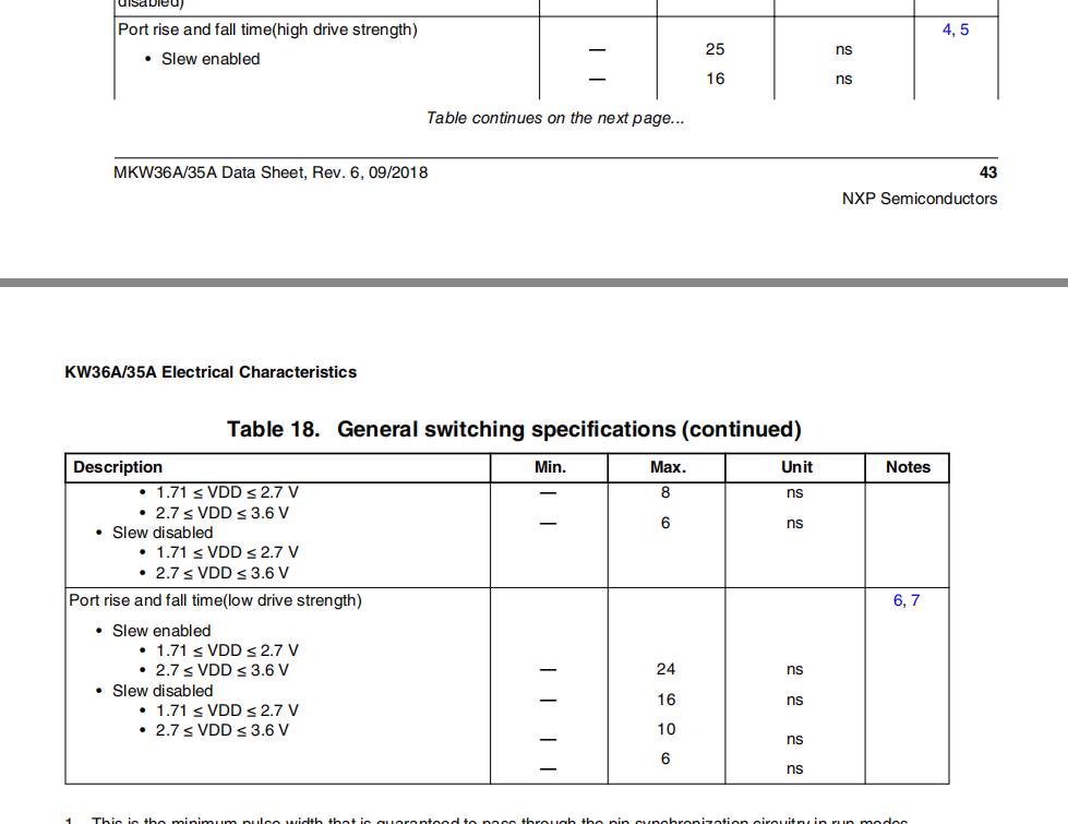

Hi, Sebastian. I find this in MKW36A/35A Data Sheet:
But in fact the rise and fall time is almost 80ns. Maybe I need a pull-up or pull-down?
Maybe the capacitance have an effect?

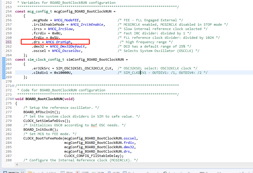

Now the clock frequency is 40MHz, is it too low? I try to change the clock frequency but it runs into hardfualt. This is my code:
3,067 Views
Sebastian_Del_Rio
Hi Mo Xinyu,
The KW36Z can run at a maximum frequency of 48MHz, so setting the system clock to a multiplier resulting in a higher frequency than that would result in a hard fault.
You can try to set the maximum frequency by using the clocks tool included in the MCUXpresso Config Tools.
Still, even after changing the frequency value, the PWM signal may still look distorted.
