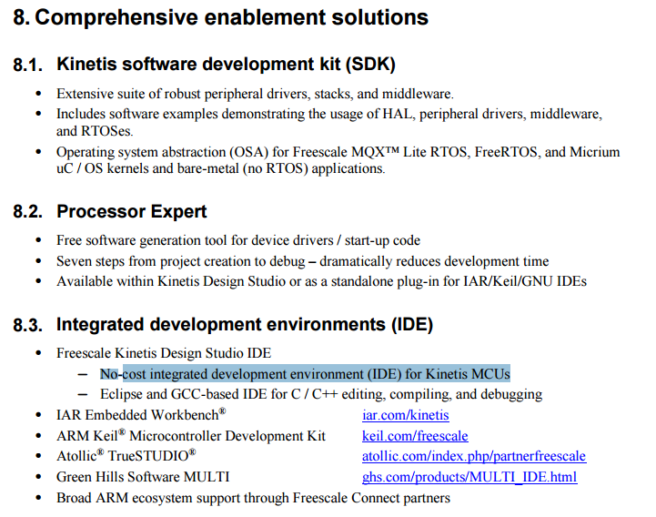

hello
kinetis IDE not suport kinetis series M
thanks

Hello andreas,
No. Kinetis M series are not supported in KDS because are not supported by KSDK.
So KDS and KSDK are released together and KDS supports just devices that are currently supported by KSDK.

ivadorazinova
Hi andres baena,
list of supported devices you find at your current version of CW C:\Freescale\CW MCU v10.6\MCU\ProcessorExpert in file README.txt
If I look at README.txt for 10.6.3 version, I don´t see support for KMx family.
You can check it in the newest version CW,
New CodeWarrior for MCU v10.6.4 available
I hope this helps,
Have a nice day,
Iva

ivadorazinova
Hello Mark,
actually coming soon TWR-KM34Z75M for KM family as Standalone version (unfortunately no support for MKM33Z64ACLH5),
after Eclipse Update you will see in KDS IDE:
but either for this case unfortunately is no PEx support.
Sorry for any inconvenience this may cause.
Iva

BlackNight
There will be an update coming out these days supporting KM14, KM33 and KM34 with bare metal projects.
I'll post here a note once it is available for download.
Erich
