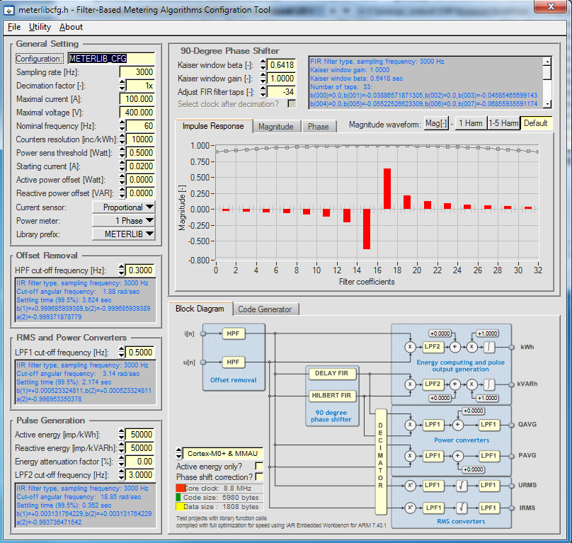

         I am trying the twr_emeter demo in TWR-KM34Z50 board.While testing  the Voltage and Ampere readings were changing very slowly.It takes approximate 10 sec to stabilise.I nead to adjust the response time to 20ms(1 cycle of 50Hz).
Is there any parameter to adjust the response time and average counts?.Please help me to solve this.

Hi Venkat!
Please, did you use the filter-based metering configuration tool for your configuration?
Did you have correctly set these parameters?
Please let me know if this helps.

1) I tried adjusting the HPF and LPF1 settings and i can able to get better response.
In HPF the least settiling time is 0.036sec and in LPF1 0.036sec is the least time.So the total settling time neaded for
correct reading is 0.72 sec.Am i correct? or the settling time of LPF2(least time) 0.217sec also come into the total time.
Please clarify me and help me to reduce this to 0.02 sec ie 20ms(one cycle time of 50hz)

ivadorazinova
Hi Venkat.
I apologize for my late response.
Transfer delays on cascade of the filter is equal to the sum of all transfer delays.
So, if the signal passes through two filters - every has 36ms and then the result is equal to 2*36ms = 72ms
If it passes through three filters, where two of them has 36ms and the one has 217ms = then result is (36+36+217)ms.
In general, if you need low transfer delay, the filter must quickly converge,  but this convergence will affect very negatively transfer and phase characteristic. Thus you will quickly measure but with a large measurement error.
If you need quickly measure and accurately is suitable to use FFT algorithms, there is not settling time. The result is accurate and stable already after the first calculation.
Please, see for more details
