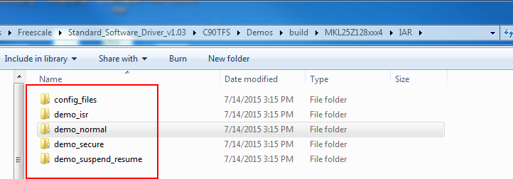

Hello Anyone knows how to write data on flash memory in KL25Z FRDM board.. i am knew to this.. can anyone provide read and write code .. and how to do that.. i am using IAR ..

Hi Mahammad,
You can also refer to "C90TFS-FLASH-DRIVER-DEVD "(download from here : http://www.freescale.com/search?site=fsl_en&proxystylesheet=search_style_fe&oe=UTF-8&ie=UTF-8&ud=1&o...  ) .
This software contains the Flash program/erase drivers for Freescale's microcontrollers.,  and after you install it , the KL25 demo on IAR about flash  you can found here :
...\Freescale\Standard_Software_Driver_v1.03\C90TFS\Demos\build\MKL25Z128xxx4\IAR
