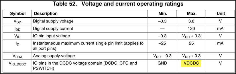

The max voltage of the DCDC IO pins (DCDC_CFG and PSWITCH) is VDCDC_IN (4.25V max in buck mode). From the datasheet:
The reason that PSWITCH is not recommended to be shorted to VDCDC_IN in Li-ion configurations is to avoid over discharge, as this my damage this kind of battery and reduce its life-time. When PSWITCH is tied high, the DCDC will always try to turn on, so when using Li-ion rechargeable battery, we recommend to use PSWITCH to turn on the DCDC. The software then can monitor the VDCDC_IN periodically and shut off the DCDC if the battery voltage becomes to low.
