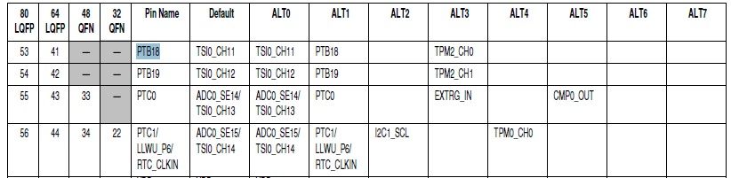

I cannot understand pretty well your inquiry, but below you will find steps to follow in order to configure any Port pin or PTBx to use it as output and send a high or low level for a specific pin, please see below:
  1. Check on Pinout wich pin you want to use, in this case I will use as example PTB18. Pinout.jpg
  2. The first thing you need to do in your code is enable system clock gating for the port you want to use, in this case I will use microcontroller KL25 but you can look for the SIM in which you can enable a specific port, in this case I need to enable clock gating for Port B with this instruction: SIM_SCGC5 |= SIM_SCGC5_PORTB_MASK;
  3. On newer microcontrollers each physical pin could have more than one possible function, then you need to choose which function you want to use for your pin, in this case we want to use is as GPIO (General Purpose Input/Output) then you select the ALT option for your pin that corresponds to GPIO. To do it use this instruction: PORTB_PCR18 = PORT_PCR_MUX(1); Pinout.jpg
  4. Next step requires to configure data direction for the specific pin you want to use with the Data Direction register for each data port, in this register if you set a bit of the port this means that bit will be an output, otherwise if you clear a bit on the register that means that bit will be an input. As example I will configure PTB18 as output with this instruction: GPIOB_PDDR |= (1 << 18);

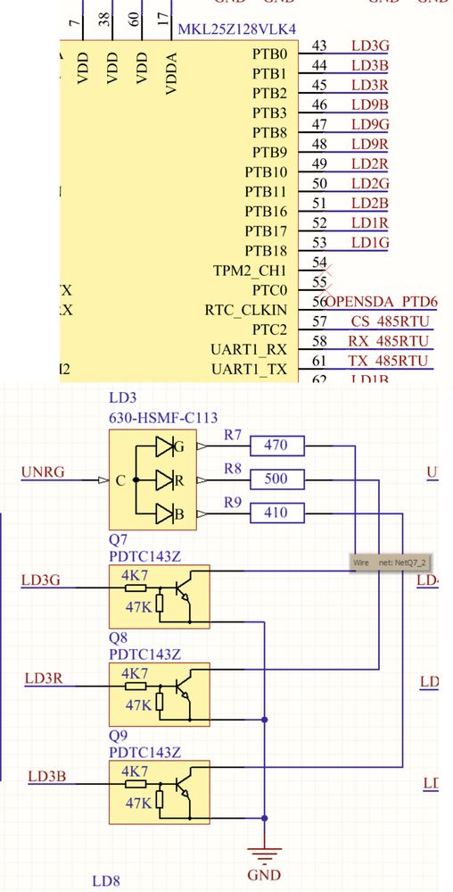

sacchettigiampa
thanks for your collaboration, it is the first time you use freescale, I would like to know how to drive PTBX to get high (VDD) for driving the NPN transistor, how can I drive TRISTATE PORT ?? Now is LOW (GND) a command TRUE et HIGH (VDD) a command FALSE.
What procedure for configuration PORT  is VALID for this schematic??
Thanks for you patient, best regards

sacchettigiampa
Hi Perla
Thank you very much for your time is really useful, I understand how it works
