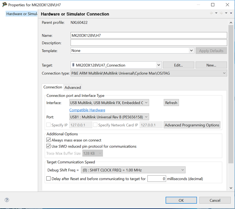

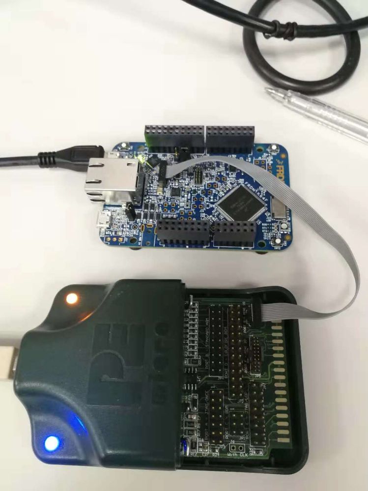

I made a test on my board. Some messages is same as yours. But it really can work. I download the bin file successfully. Below are the photo and screenshot.
After download, re-plug the usb cable, windows will show a new disk named MAINTENANCE.
1. connection
2. setting
3 setting 2(connection edit)
4. context in CW console window
fl::target -lc "LC for Simple Flash (1)"
fl::target -b 0x1fffe000 0x4000
