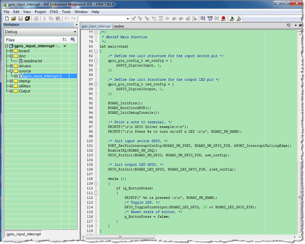

This is my abortive attempt to get an interrupt on the rising or falling edge of Port D bit 0:
SIM->SCGC5 |= SIM_SCGC5_PORTD_MASK; // Enable Clock to Port D //
PORTD->PCR[0] = PORT_PCR_MUX(1); // Make bit 0 of port D available for GPIO
PORTD->PCR[0] |= PORT_PCR_IRQC(0x0B);
PORTD->PCR[0] |= PORT_PCR_ISF(1); // clear interrupt flag
PTD->PDDR &= 0xFFFFFFFE; // Make D0 an input

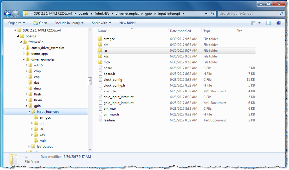

Hi Sam,
Please refer the gpio input_interrupt example in SDK_2.2.1_MKL17Z256xxx4. (...\SDK_2.2.1_MKL17Z256xxx4\boards\frdmkl43z\driver_examples\gpio\input_interrupt)
You can download the SDK_2.2.1_MKL17 package refer Generating a downloadable MCUXpresso SDK v.2 package.
Robin
