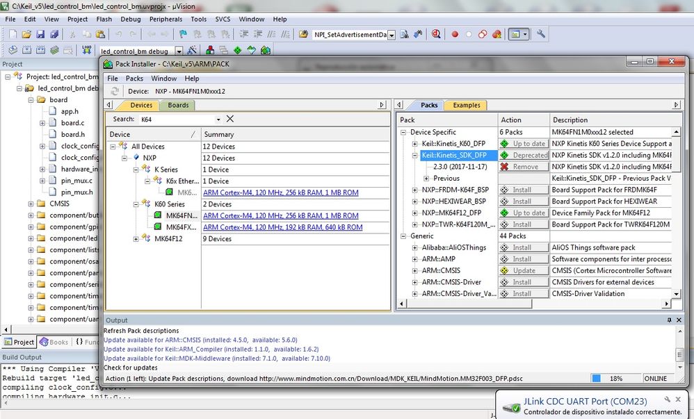

  2. You can also try the CMSIS DAP debugger
   OpenSDA Serial and Debug Adapter | NXP
  Please help you to check what's the PC system you are using? If you are using the win10, you may also need to use the external debugger to update your FRDM-K64 onboard K20 bootloader firmware.
  More details, please check the above opensda link.
  I find your test project seems not from the SDK directly, so please download the newest SDK project, check your PC system, and the opensda, also test the CMSIS DAP debugger firmware.

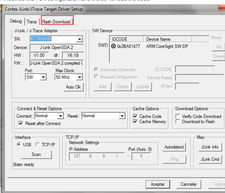

faundez
hi,
I modified the Port configuration and it tries  to load the code
but it fails during verification
JLink info:
DLL: V6.10i, compiled Oct 25 2016 19:31:51
Firmware: J-Link OpenSDA 2 compiled Oct 13 2015 12:10:27
Hardware: V1.00
S/N : 621000000
* JLink Info: Found SWD-DP with ID 0x2BA01477
* JLink Info: AP-IDR: 0x24770011, Type: AHB-AP
* JLink Info: Found Cortex-M4 r0p1, Little endian.
* JLink Info: FPUnit: 6 code (BP) slots and 2 literal slots
* JLink Info: CoreSight components:
* JLink Info: ROMTbl 0 @ E00FF000
* JLink Info: ROMTbl 0 [0]: FFF0F000, CID: B105E00D, PID: 000BB00C SCS
* JLink Info: ROMTbl 0 [1]: FFF02000, CID: B105E00D, PID: 003BB002 DWT
* JLink Info: ROMTbl 0 [2]: FFF03000, CID: B105E00D, PID: 002BB003 FPB
* JLink Info: ROMTbl 0 [3]: FFF01000, CID: B105E00D, PID: 003BB001 ITM
* JLink Info: ROMTbl 0 [4]: FFF41000, CID: B105900D, PID: 000BB9A1 TPIU
* JLink Info: ROMTbl 0 [5]: FFF42000, CID: B105900D, PID: 000BB925 ETM
* JLink Info: ROMTbl 0 [6]: FFF43000, CID: B105900D, PID: 003BB907 ETB
* JLink Info: ROMTbl 0 [7]: FFF44000, CID: B105900D, PID: 001BB908 CSTF
ROMTableAddr = 0xE00FF000
Target info:
Device: MK64FN1M0xxx12
VTarget = 3.300V
State of Pins:
TCK: 0, TDI: 0, TDO: 0, TMS: 0, TRES: 0, TRST: 1
Hardware-Breakpoints: 6
Software-Breakpoints: 8192
Watchpoints: 4
JTAG speed: 1429 kHz
Erase Done.
Programming Done.
Contents mismatch at: 0000001CH (Flash=00H Required=96H) !
Contents mismatch at: 0000001DH (Flash=00H Required=E6H) !
Contents mismatch at: 0000001EH (Flash=00H Required=FCH) !
Contents mismatch at: 0000001FH (Flash=00H Required=DFH) !
Verify Failed!
Error: Flash Download failed - "Cortex-M4"
Flash Load finished at 16:07:57
11,761 Views

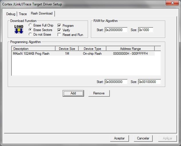

kerryzhou
Hi Marcos Faundez Zanuy,
  Click flashdownload item :
Do you add the flash download algorithm?
I still suggest you try the official SDK MDK project directly.
Wish it helps you!
Kerry

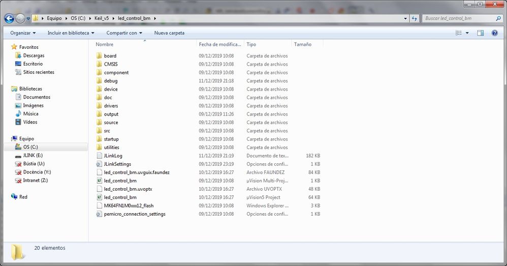

faundez
hi Kerry
I see this screen
and yes, I'm using the example provided by NXP led_control_bm

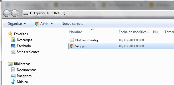

in my jlink disk (the freescale board) there is a text file that says No valid VMSD configuration for target flashing found.
but I don't know how to fix that (where should I get this file?) NXP example consists of more than 200 files just to play with leds and switches!!!
regards

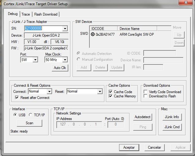

faundez
HI Mark
yes, I see this disk
then I follow the web link, which brings to this page https://www.segger.com/products/debug-probes/j-link/models/j-link-ob/  where I check that the debugger is j-link.
then I set this debugger:
I accept the terms
and I get this error
in the build line I can read
JLink info:
Hardware: V1.00
S/N : 621000000
***JLink Error: Debugger tries to select target interface JTAG.
This interface is not supported by the connected emulator.
Selection will be ignored by the DLL.
Error: Flash Download failed - Target DLL has been cancelled
Flash Load finished at 23:29:23
but I don't know how to fix that. Note that I don't have any additional hardware for debugging. Just the freescale development kit. I'm trying to execute the suggested example available in NXP website
regards
Marcos
PD: in case it helps: I installed again the packs for K6x but I got the same result
11,761 Views

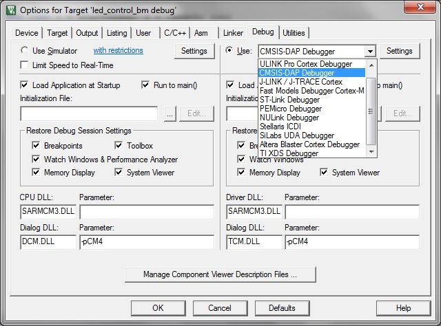

mjbcswitzerland
Specialist V
It says why it doesn't work - you still need to configure the debugger in the Segger JLInk setup.
This is a general ergonomics nightmare in uVision: It has to in fact be set up twice in two locations....

faundez
hi, many thanks, I Will try this  https://www.segger.com/products/debug-probes/j-link/technology/ides/keil-mdk/  this afternoon.
however, this is NOT a general keil problem. With Texas launchpad tiva is by far much more simple. It's a problem with this debugger.
regards

mjbcswitzerland
Specialist V
When you plug the FRDM-K64F into your PC it will show up as an external hard-drive and there you can see which debugger/loader is installed (it could be CMSIS-DAP, Jlink or PEMicro). Select this and then go into the debugger setting and set details, such as SWD mode.
You can get complete ready-to-build uVision projects for FRDM-K64F at the uTasker open source GIT hub link (USB, Ethernet, SD card, etc.)

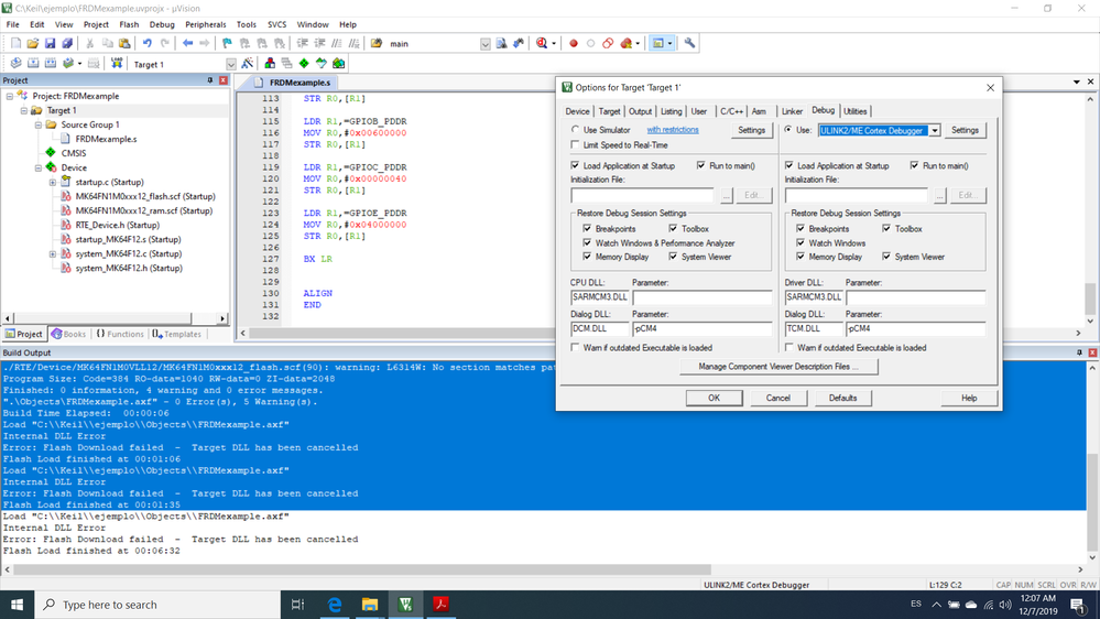

Load "C:\\Keil\\ejemplo\\Objects\\FRDMexample.axf"
Internal DLL Error
Flash Load finished at 00:14:40
2. When I try to load the code in the FRDMK64 board I got the following error: no ulink2/ME device. I think this is because I have not setup the proper debug. According to Keil it seems that this board uses JTAG/SW (MDK5 - NXP FRDM-K64F  ). However, I do not see this option available in keil 5.29. How should I fix that? Please, consider that this is my first time trying to work with this development board. My previous experience is with launchpad TIVA TM4C123 mainly in C
