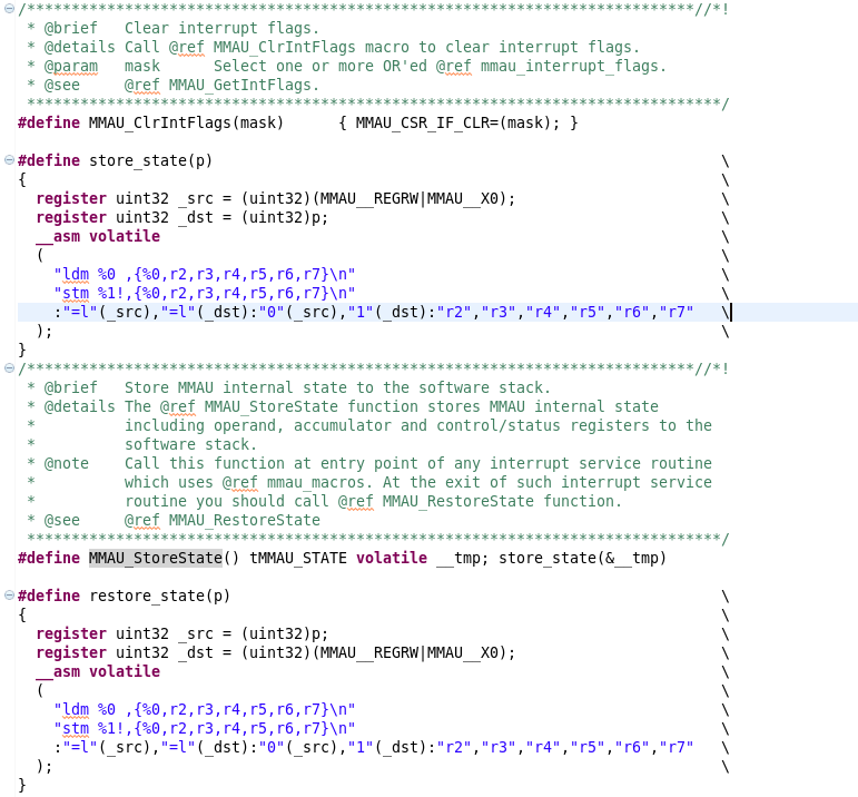

Hi ,
If I want to use the freeRTOS with MMAU in a KM34Z MCU. Do I need to some port.c modification in order to use MMAU without troubles?
e.g the store /restore the MMAU registers?
Thanks!

Hi Nick,
from MMAU initialization point of view as Jing explained above - no special steps needed.
Yes MMAU register context save / restore would have to be handled by FreeRTOS if MMAU is used in more tasks. In this case, most likely, portasm.s would have to be be extended by saving/restoring MMAU registers.
If you plan using MMAU in single task then no saving/restoring MMAU is required and use can use current FreeRTOS files.

nickng
Hi Jing,
Thanks for your reply!
My question is focusing on the context switching ( or interrupts) of the RTOS with that specific MMAU registers.
For a bare metal system, with can use the pair of store and restore action of those mmau register. Do I need to do the same on the port.c ?
here are the store/restore pair :
