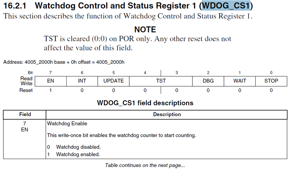

I have disabled the watchdog timer, but it seems to be reset by the watchdog timer.
The following sources. I am using SDK_2.6.0_MKE04Z128xxx4.
Disable the watchdog timer.
  WDOG8_GetDefaultConfig (& wdogConfig);
  wdogConfig.timeoutValue = WDOG_TIMEOUT;
  wdogConfig.enableInterrupt = true;
  wdogConfig.enableWdog8 = false;      // for debug
  WDOG8_Init (WDOG, & wdogConfig);
So, at startup, check with the following function at the beginning.
bool boardResetWDT (void)
  uint32_t bl = SIM_SRSID_WDOG (1);
  uint32_t srsid = (SIM-> SRSID);
  if ((bl & srsid)! = 0u) {  // 1 Reset caused by WDT
    return true;
  return false;
Then it will return true.
I left it unattended and restarted surely, so I was investigating whether the watchdog was the cause, but even if I disabled it, it restarted and it seems that the watchdog is the cause, but what is happening? Is not it?

It seems that it was reset because the watchdog timer was not cleared within 16 cycles (an interrupt was inserted in between). After clearing the watchdog timer in the interrupt disabled state, the reset no longer occurs.

Have you enabled the watchdog  before you disable the wadg?
Can you refer this link to check if wdg went to wdg_handle.https://community.nxp.com/t5/Kinetis-Microcontrollers/disabled-the-watchdog-timer-but-reset-by-the-w....
And can you debug to check if WDOG_CS1.7 has been set  after you disabled the wdg.
