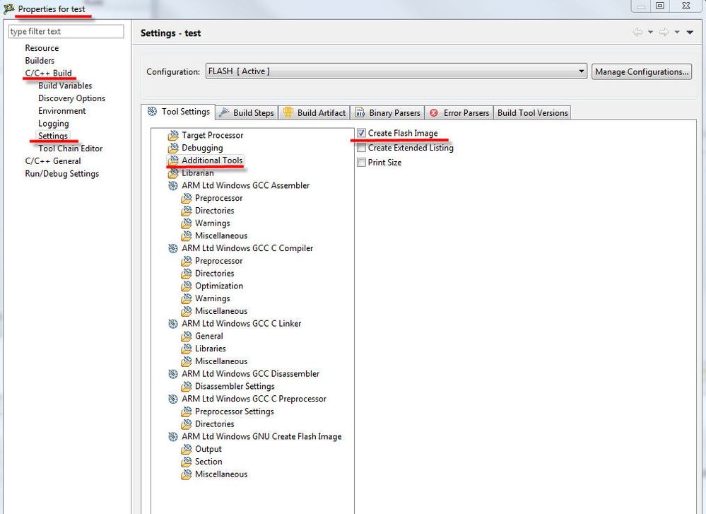

environment:coderwarrior 10.4
MCU:the MKL20 MCU
Burner:P&E micro
I build a bareboard project.
When I debug will appear as
shown in the annex of the case.
It will run over with no error When I run,
but no code download to the Flash.
Please tell me ,How can I do to solve
this problem.

Hi Chen Xin,
About how to generate ".hex" image file of CW V10.4 project.
In CW project Properties, select [C/C++ Build] -> [Setting] ->[Additional Tools]: select [Create Flash Image]

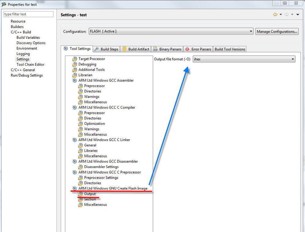

Then In [ARM Ltd Windows GNU Create Flash Image] select [Output file format]:
Then you can recompile the project and in [FLASH] target folder, you will find genrated ".hex" image file.
Wish it helps.
