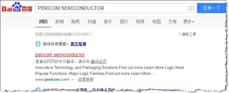

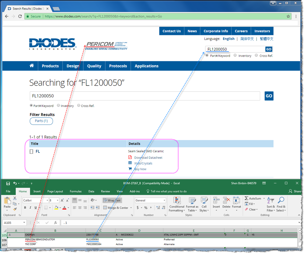

I want know the what Mfr. Part Number is? which website can I find the number so that I can find the the components of Y1 and Y5.
5,684 Views
Robin_Shen
If you search PERICOM SEMICONDUCTOR in www.baidu.com. You will get the website of it.Diodes Incorporated
Then you just need to search FL1200050.
Robin

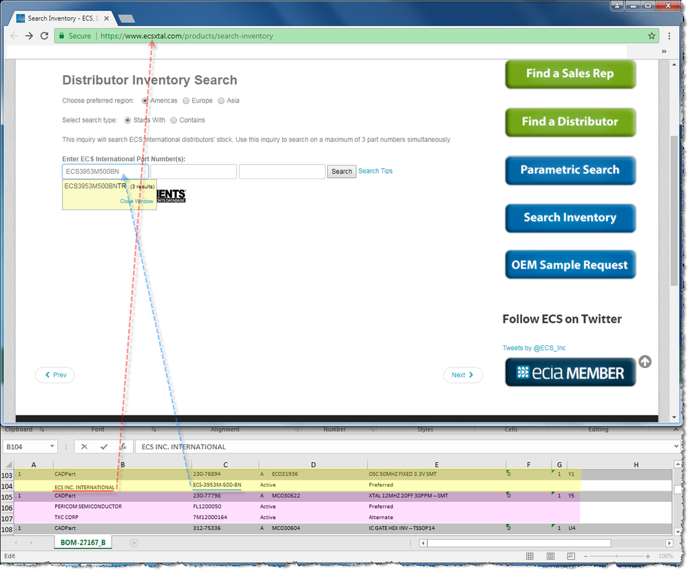

minminzhengzhen
hello,
what is the CADPart?
Are there two lines for Y1?
Which one is the website of the company?
5,678 Views
Robin_Shen
There is no Alternate for Y1.
You can search ECS INC. INTERNATIONAL and find it's websie:https://www.ecsxtal.com/.
Then search ECS3953M500BN and buy it from Distributor.
Robin
