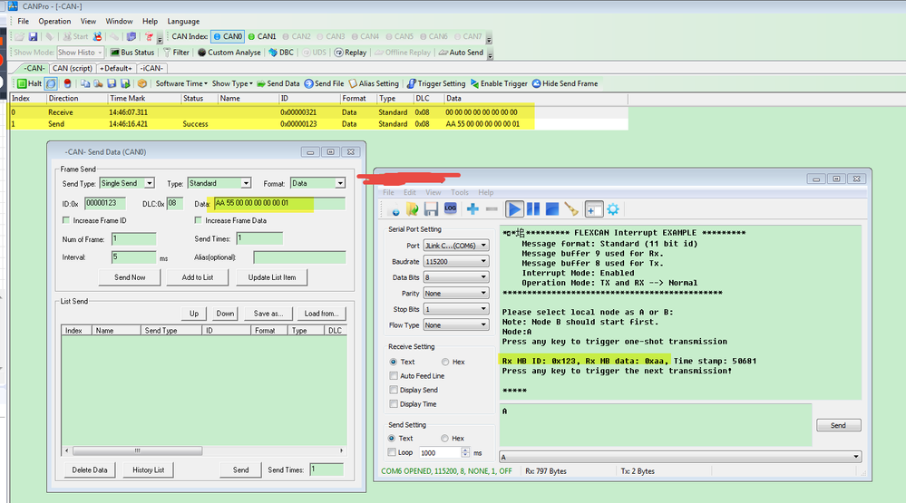

When run the flexcan driver demo (nterrupt transfer) out of the box, the baudrate is supposed to be 1Mbps but at the oscilloscope we "see" only  138.9 KHz
How can we set the baudrate properly? We would like to get 250Kbps, but we are unable to get that baudrate.

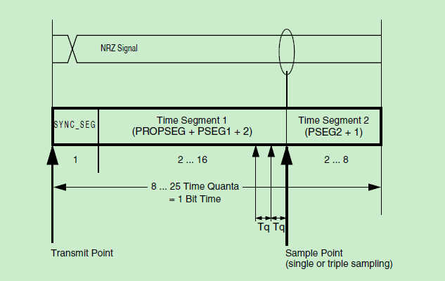

Here CAN Bit Time Calculation  we observe that no baud rate is compatible with 75MHz as core clock as configured  by default in the demo.

   Today, I check the SDK code on my side, frdmkv11z_flexcan_interrupt_transfer. SDK2.7.0.
   Find some code bugs, and I have modify it, it can transfer the 1Mbps and the 250Kbps now.
  1. 1Mbps Modification points:
1)
/*#define PSEG1 5
#define PSEG2 2
#define PROPSEG 1
#define PSEG1 4
#define PSEG2 1
#define PROPSEG 1

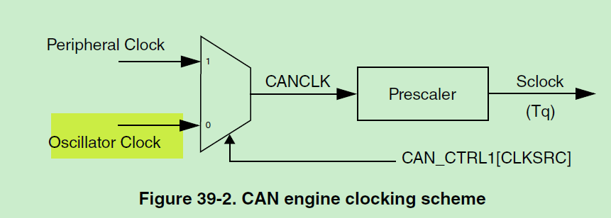

2) #define EXAMPLE_CAN_CLK_FREQ 10000000//CLOCK_GetFreq(kCLOCK_CoreSysClk)
or #define EXAMPLE_CAN_CLK_FREQ CLOCK_GetFreq(kCLOCK_Osc0ErClk)
Just select the external 10Mhz crystal as the clock source.
#define EXAMPLE_CAN_CLK_SOURCE (kFLEXCAN_ClkSrc0)
 flexcanConfig.clkSrc = EXAMPLE_CAN_CLK_SOURCE;
Test Result:

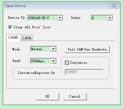

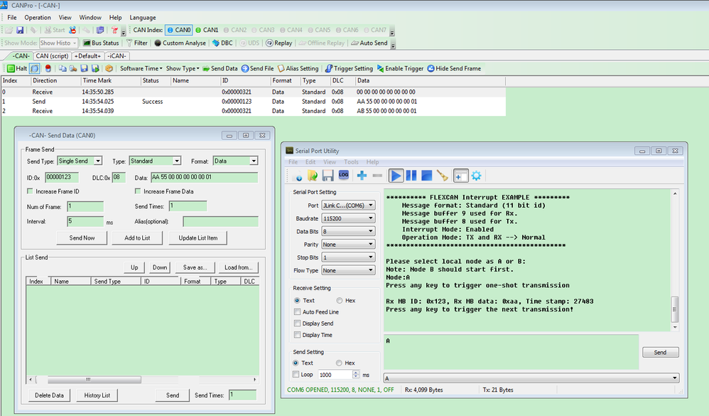

2. Your desired 250Kbps modified points:
  1)
//250Kbps
#define PSEG1 4
#define PSEG2 1
#define PROPSEG 1
2) void FLEXCAN_GetDefaultConfig(flexcan_config_t *pConfig) in fsl_flexcan.c
/* Assertion. */
assert(NULL != pConfig);
/* Initializes the configure structure to zero. */
(void)memset(pConfig, 0, sizeof(*pConfig));
/* Initialize FlexCAN Module config struct with default value. */
pConfig->clkSrc = kFLEXCAN_ClkSrc0;
pConfig->baudRate = 250000U;//1000000U;
I also attach my modified project for your desired 250khz, it works Ok now.
Also provide the oscilloscope 250Kbps wave:
  bit rate is correct!

Kerry, thank you again for your rapide response.
I think there are some things in your post that do not match with what I see in the doct:
You wrote Time Segment 1 = PSEG1 + 1 but according to the reference manual it's PROPSEG + PSEG1 + 2
after you wrote (4+PROPSEG+PROPSEG+PSEG1) but I think you meant (4+PROPSEG+PSEG2+PSEG1)
With the formula:
4+PROPSEG+PSEG2+PSEG1 = 10
==> TS1 + TS2 = 9
How do you choose between line 1 or 2 of Table 39-14 ?
I mean TS1(7) + TS2(2) = TS1(6) + TS2(3) = 9

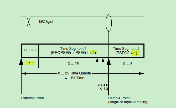

Hi Roberto Quilez,
   Your understanding is wrong, seems you didn't check my picture which is from the KV11 RM:
  bit time after clock divide is : SYNC_SEG+PROPSEG+PSEG1+2+PSEG2+1.
  SYNC_SEG=1.
Then, you will know it is 4+PROPSEG+PSEG1+PSEG2
Please note PROPSEG,PSEG1,PSEG2 are the register value.
Time segment 1= PSEG1+1, Time Segment 2= PSEG2+1
The following picture is after +1
So 4+PROPSEG+PSEG2+PSEG1 = 10, it is 1+(Time segment 1=PSEG1+1)+(Time segment2=PSEG2+1)+(jump width=PSEG1 +1)
If  PROPSEG=1 ,jump width=2, I want PSEG2+PSEG1+2 = 7, it is Time segment 1+ Time segment2=7.
So, if Time segment1 =5, Timesegment 2=2, it is 7, meet the demand.
Wish it really helps you to understand it.
Maybe you also need to double read the KV11 RM carefully.
If you still have questions about it, please kindly let me know.
Kerry
3,916 Views
robertoquilez
Ok, you are right, thank you very much.
My misunderstanding was due to the first picture where we see:
 Timer segment 1 = PROPSEG + PSEG1 + 2
When the formula to apply is:
Time segment 1= PSEG1+1.
Thank you very much for your support, again.
