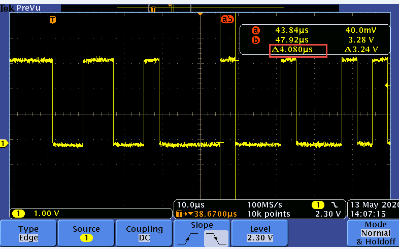

robertoquilez
When run the flexcan driver demo (nterrupt transfer) out of the box, the baudrate is supposed to be 1Mbps but at the oscilloscope we "see" only  138.9 KHz
How can we set the baudrate properly? We would like to get 250Kbps, but we are unable to get that baudrate.
Here CAN Bit Time Calculation  we observe that no baud rate is compatible with 75MHz as core clock as configured  by default in the demo.

   Today, I check the SDK code on my side, frdmkv11z_flexcan_interrupt_transfer. SDK2.7.0.
   Find some code bugs, and I have modify it, it can transfer the 1Mbps and the 250Kbps now.

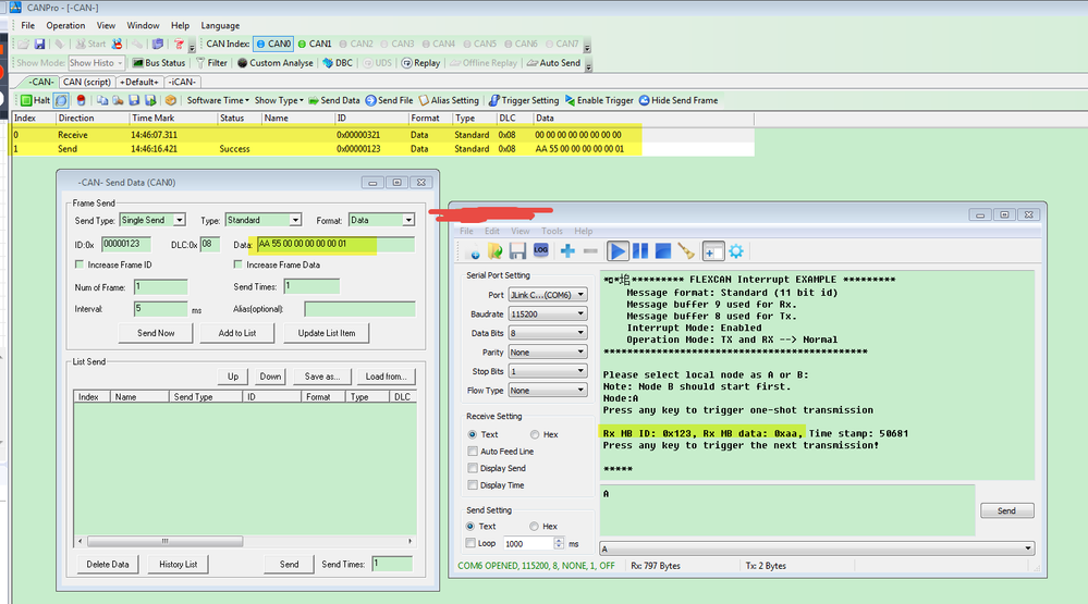

Test Result:

I also attach my modified project for your desired 250khz, it works Ok now.
Also provide the oscilloscope 250Kbps wave:
  bit rate is correct!
  Test platform: FRDM-KV11Z

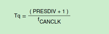

Please note, Time segment 1= PSEG1+1, Time Segment 2= PSEG2+1
So, if you want to get 1Mbps, but your fCANCLK is external crystal 10Mhz.
What does it mean?
1Mbps= (10M/(PRESDIV+1))/(4+PROPSEG+PROPSEG+PSEG1).
If choose PRESDIV =0, no divide clock.
Then it means your 4+PROPSEG+PROPSEG+PSEG1= 10, then you need to check table 39-14, find item 1 is the proper one.

You wrote Time Segment 1 = PSEG1 + 1 but according to the reference manual it's PROPSEG + PSEG1 + 2
after you wrote (4+PROPSEG+PROPSEG+PSEG1) but I think you meant (4+PROPSEG+PSEG2+PSEG1)

  bit time after clock divide is : SYNC_SEG+PROPSEG+PSEG1+2+PSEG2+1.
  SYNC_SEG=1.
Then, you will know it is 4+PROPSEG+PSEG1+PSEG2
Please note PROPSEG,PSEG1,PSEG2 are the register value.
The following picture is after +1
So 4+PROPSEG+PSEG2+PSEG1 = 10, it is 1+(Time segment 1=PSEG1+1)+(Time segment2=PSEG2+1)+(jump width=PSEG1 +1)
If  PROPSEG=1 ,jump width=2, I want PSEG2+PSEG1+2 = 7, it is Time segment 1+ Time segment2=7.

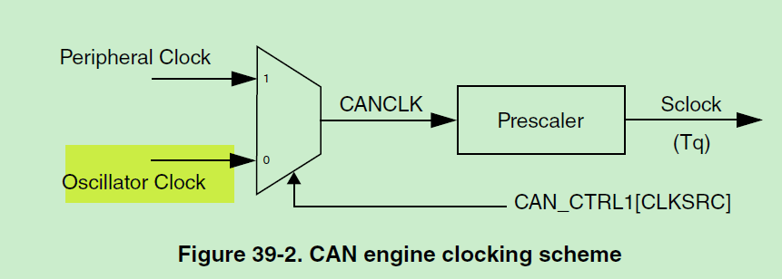

My misunderstanding was due to the first picture where we see:
 Timer segment 1 = PROPSEG + PSEG1 + 2
When the formula to apply is:
Time segment 1= PSEG1+1.
Thank you very much for your support, again.
