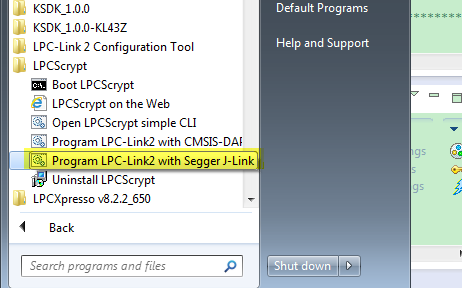

Answer: You can use the LPC-LINK2 to program your MKM14Z64CHH5, but I suggest you use the LPC-LINK2 with the JLINK firmware.
         You can use the LPCScrypt to change the LPC-LINK2 firmware, which can be download from this link:
LPCScrypt v2.0.0|NXP
② If there is a problem, is there any writer recommended by NXP?
Answer: LPC-LINK2 with JLINK can debug your chip, it's no problem.
   About the other programmer or debugger, you can use: Segger JLINK, P&E Multilink, both these debugger can be used on your side.
