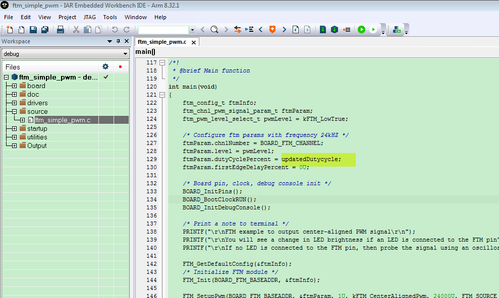

   1. Of course you can see the PWM waveform when no motor is connected.
     I think you check the FTM PWM from the MCU side at first, then check the driver output, if the PWM all works OK as your demand, then you can power off and add your motor.

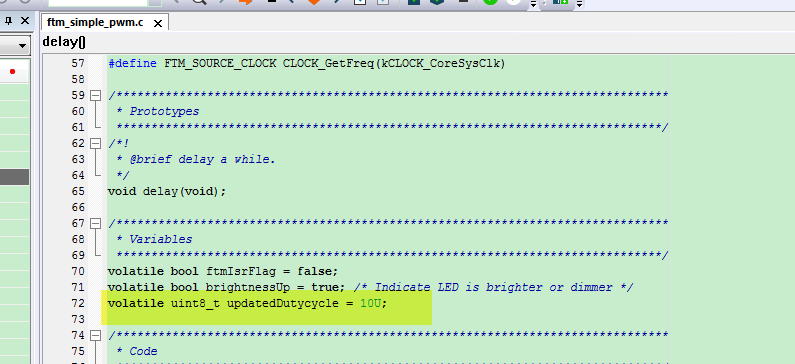

2. SDK can't change the duty when you modify CnV.
   I think you modify the wrong place, maybe even you modify the CnV, but in the code, below your modified point, the SDK also use the old duty, that's why you can't modify it.
  Actually, you can change the duty cycle directly instead of modify the CnV register.
Please try it again on your side.
You can change the updateDutycyle data directly to change your PWM duty.
Wish it helps you!

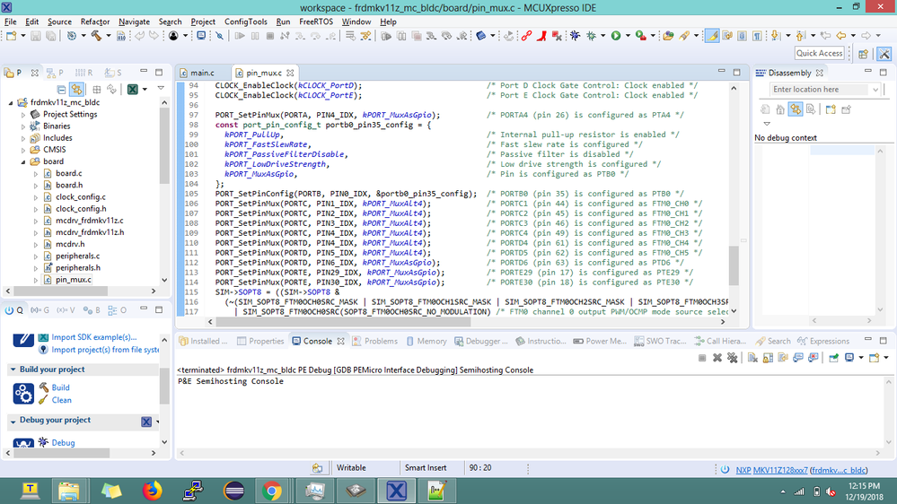

Thank you for the help, but I am using the "frdmkv11z_mc_bldc" example. I am able to see the PWM waveform when I'm using the "ftm_simple_pwm" example and the "ftm_pwm_twochannel", no issues in that.
The problem comes when I use the "mc_bldc" example from the demo_apps folder.
In that example it is using 6 channels which are - C1,C2,C3,C4,D4 and D5.
And the dutycycle is set in the "InitFTM0()" funtion as shown below.
I am not making ANY CHANGES in the duty cycle. Im using this "mc_bldc" example just as it is , with out any changes made.
So the example code sets 50% as duty cycle. But when I connect the MC-LV-BLDC Driver shield with the FRDM Kv11z and Power Up driver using 12V power source. I'm not getting the waveform on my channels with 50% duty cycle.

I think I'm missing some minute detail here. Like on which pin to measure my PWM signal. I tried measuring the PWM waveform from the Output ports of BLDC driver as well, which is PHA , PHB and PHC ports which are Phase A , Phase B and Phase C output ports of my MC-LVBLDC driver.
