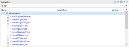

Hello @GanesanGuru,
Could you please try downloading again the SDK v2.14.0? You could download it from the MCUXpresso IDE or from Welcome | MCUXpresso SDK Builder. If you are going to download it from the SDK Builder, please make sure you have Metering Library check before click on Download SDK, as follows:
[MCUXpresso SDK Builder -> Build SDK]
Using MCUXpresso IDE v11.8.0 and TWR-KM35Z75M SDK v2.14.0 we got the following examples under demo_apps:
[MCUXpresso IDE v11.8.0 -> SDK Import Wizard]
Also, we share you some application notes that could be useful to Metering applications:

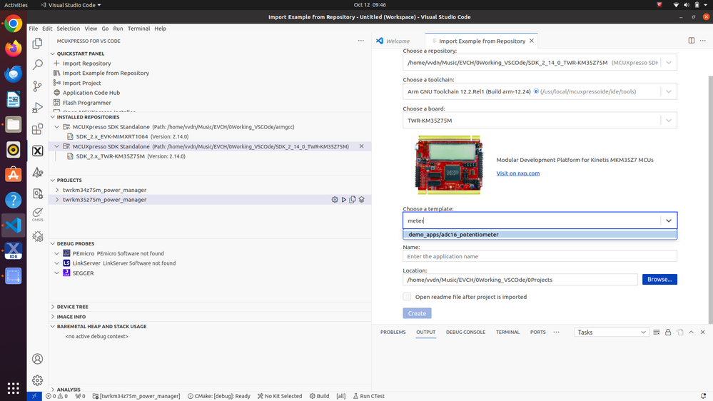

GanesanGuru
Hi @RaRo,
That's really appreciative @RaRo . I can replicate the same now.
What keeps me wondering is, I've preferred VSCode's Extension previously and for the same I was not able to do it,as illustrated in attachment. Why is it so?Screenshot from 2023-10-12 09-46-31.pngScreenshot from 2023-10-12 09-46-31.png

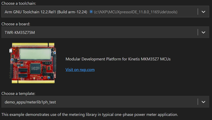

RaRo
Hello @GanesanGuru ,
Great discovery! After comparing the newest SDK with the v2.13.0 (the older one), it seems the newest SDK is missing the folder armgcc in the metering examples. The armgcc contains the CMake build files which are essential to import the metering examples.
If you want to use VSCode's MCUXpresso Extension instead of MCUXpresso IDE, please use the SDK v2.13.0 which would let you import the metering examples.
[Import Example from Repository with SDK v2.13.0]
At the meantime, we are going to let the team in charge to know about this. Thank you for noticing this issue.
