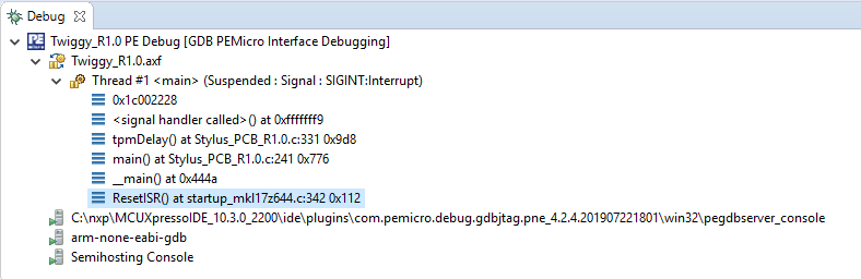

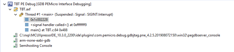

umlengineer
Also here is a screenshot of what I see when I pause the debug:
Thanks!
10,531 Views
mjbcswitzerland
Specialist V
Your call stack suggests that there is a hard fault taking place in your routine tpmDelay().
You need to show the code involved because it may be faulty.
Also download the uTasker project from GitHub and configure it for the KL27 (equivalent to KL17) and test its TPM references - documentation at http://www.utasker.com/docs/uTasker/uTaskerHWTimers.PDF
This allows the KLx7, the TPM and its interrupts to be tested in its simulator and the solutions copied where needed.
Mark

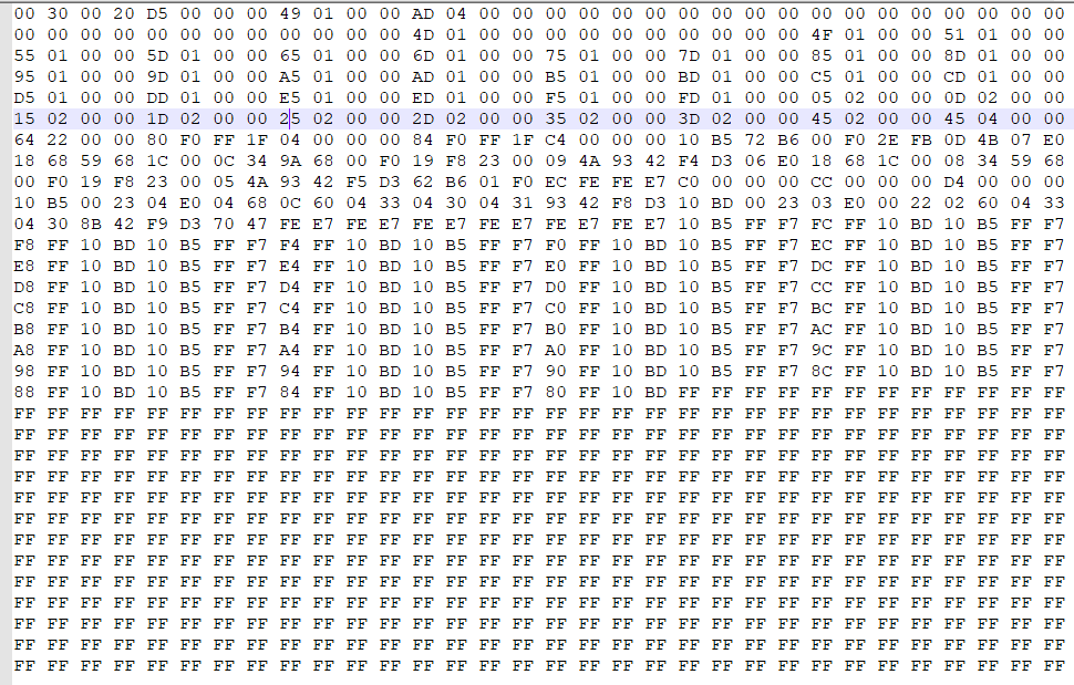

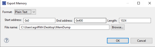

mjbcswitzerland
Specialist V
Evan
It is best to run the code and check the VTOR value in the debugger when you set a breakpoint just before when you know that it fails.
If it pints to 0 it means that it expects the interrupt vectors at the start of Flash. If it points to an address in SRAM they should be (copied to) there.
In either case you a memory dump of the first 256 long words form this address and show them in a screen shot.
The reason for either an unitialised vector or lack of hard fault handler will be visible in the screen shot.
Mark
10,531 Views

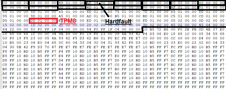

umlengineer
Here is the memory dump and how I acquired it.
Thanks!
10,531 Views
mjbcswitzerland
Specialist V
Evan
If you VTOR register is set to 0 it all looks good:
There is a hard fault handler and also a TPM0 handler in the interrupt vectors in flash at this location.
Another possibility is that you are seeing the return from the exception in your call stack (the interrupt may have executed - did you try a break point in it?) but the saved PC (on stack) has been corrupted by the handler code and so it is jumping back to an invalid address.
Mark
P.S See Exception Return behavior in the ARM Corex M4 User's Guide, where 0xfffffff9 is the EXC_RETURN value.

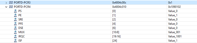

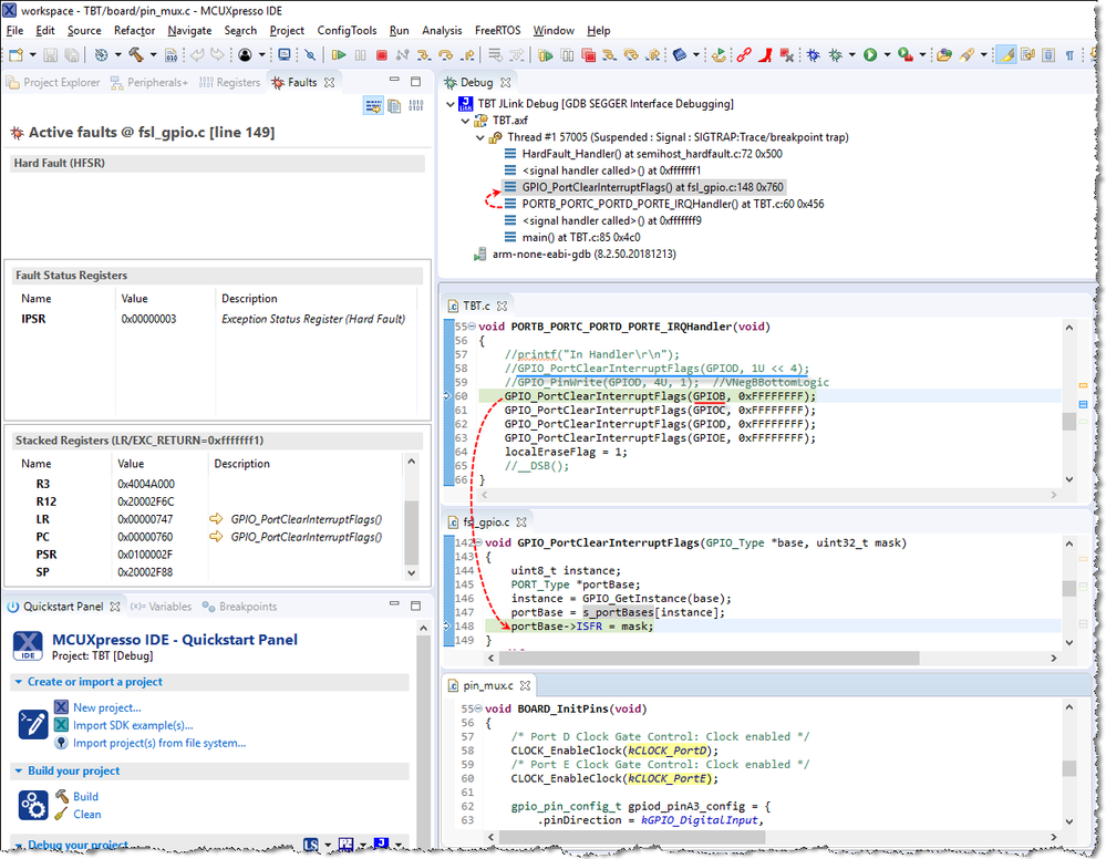

umlengineer
I can clean up my other project for release, but I am having the same issue in another project with GPIOs.  I can see that the GPIOs are triggering an interrupt and then the program is hanging because there is no handler.
I have attached that project here:  https://eink.sharefile.com/d-s89681da26d248998
Thanks!
10,531 Views
Robin_Shen
Hi Evan,
I have checked your GPIO interrupt project, hardfault is caused by GPIO_PortClearInterruptFlags(GPIOB, 0xFFFFFFFF).
You didn't enable the Clock Gate of GPIOB and GPIOC, why you clear the ISFR of GPIOB and GPIOC in PORTB_PORTC_PORTD_PORTE_IRQHandler?
According to your project, only PTD4 and PTE23 are configured as GPIO interrupt.
GPIO_PortClearInterruptFlags(GPIOD, 1U << 4); is able to clear ISFR of PTD4.
You can test it on PTD4, it will not caused hardfault anymore.
Robin
10,531 Views
umlengineer
Sorry for the confusion, I was working with someone internally and they suggested I try clearing all flags to see if that was causing an issue.  Previously I was using only the commented out line:  GPIO_PortClearInterruptFlags(GPIOD, 1U << 4);
Also I was only using pin PTD4 as my interrupt.
When I run the base code as follows I do not get a hard fault, I just do not get an interrupt.  I do however see an interrupt flag in the PORTD as indicated by the attached image.
void PORTB_PORTC_PORTD_PORTE_IRQHandler(void)
    //printf("In Handler\r\n");
