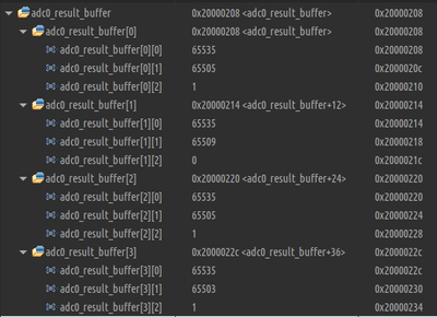

I got the code from Using DMA to Emulate ADC Flexible Scan Mode with SDK 2.x to try to implement that on my end product based on an MK10 but it is not working correctly.
I have modified the code to have DMA channel 0 as the DMA-COCO and DMA channel 1 as the SRAM to ADC0_SC1A. Also, I altered the order of execution of the various sections to match what the code does when using the config tools.

When I run the code on the MK64 board it works flawlessly, with no issues at all. But when I use the code on my MK10 it presents a weird behavior.
I'm down to register level debug on trying to know what is going on and I have observed the following:
When debugging the code, the DMA register values for both projects are exactly the same when looking at the DMA peripheral for both. These are the DMA register values for both (simplified for CH0 and CH1 only):

But when I get to the part when the LPTMR is started to trigger the ADC, after executing LPTMR_StartTimer a change happens for the MK10. The DMA-TCD1-SADDR register changes from 0x20000000 to 0x20000002 and I don't know why.
Then immediately after executing uint8_t channel = 0; the DMA-INT register changes from 0x0 to 0x3 for no apparent reason and adc0_sample_ready as well as adc0_capture_done are immediately set to true on the MK10 and I see the following on the RAM buffer:
And I don't know why all the buffer has those values.
Could anyone please help me know what's going on? The code and configurations are exactly the same for both and it works just fine for the MK64 but not for the MK10.

Since I haven't K10D100M board, I tested jorge_a_vazquez's code on TWR-K60D100M. It could be used to verify K10 project. I copied his main.c directly. The demo can works fine. Since we can't find the difference between K10 and K64 DMA module, you can use the demo code directly too to speed up your project.
Jing
