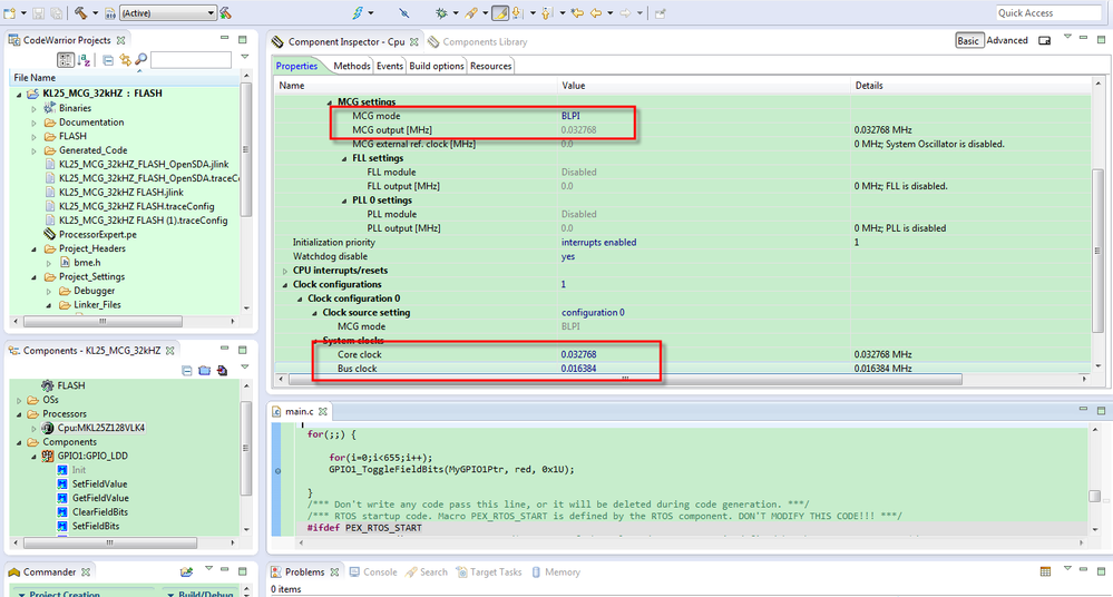

There is a reason because various kinetis mcu (kl25z, kl03, and k64f) don't work if I setting System Frequency under 100kHz (Specially at 32KHz I have ever an error during the debug) or I forgot something to set?

kerryzhou
Hi Alessio Paolucci,
  Could you tell me what debugger you are using?
  If you are using OPENSDA, it really have a debugger problem when the MCG clock is very slow, but you can download the code to your flash, and test the code function without the debuger.
  I create a KL25 project, the MCG output is 32.768Khz,  the code function is toggle PTB18.
  My code configuration is as follows:
The test result is :
(1). With OPENSDA debugger, just can download code to flash, the code function is OK.
(2).  With Jlink debugger, it can do debug operation, the code function is OK.
I think the opensda debugger have clock limitation,  so if you are using low mcg out clock, you can choose Jlink.
I also attached my testing code, you can refer to it.
Wish it helps you!
If you still have problem, please contact me!
Jingjing
