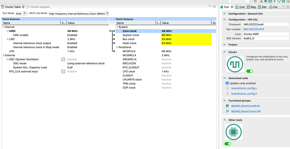

Then I guess the next question is, is there something in the config tool I am setting up wrong? Here is a screenshot of my clock config page:
So based on your and Mark's comments, because I have Core clock set to 48MHz from the HIRC then my SysTick timer should be using that clock because we confirmed SYSTICK_CSR (register at address 0xe000e010 in the Cortex M0+ core) bit 2 is set. That means my SysTick timer clock should be set correctly. Is there another reason why my SysTick timer might not work on my board but does on the FRDM board?

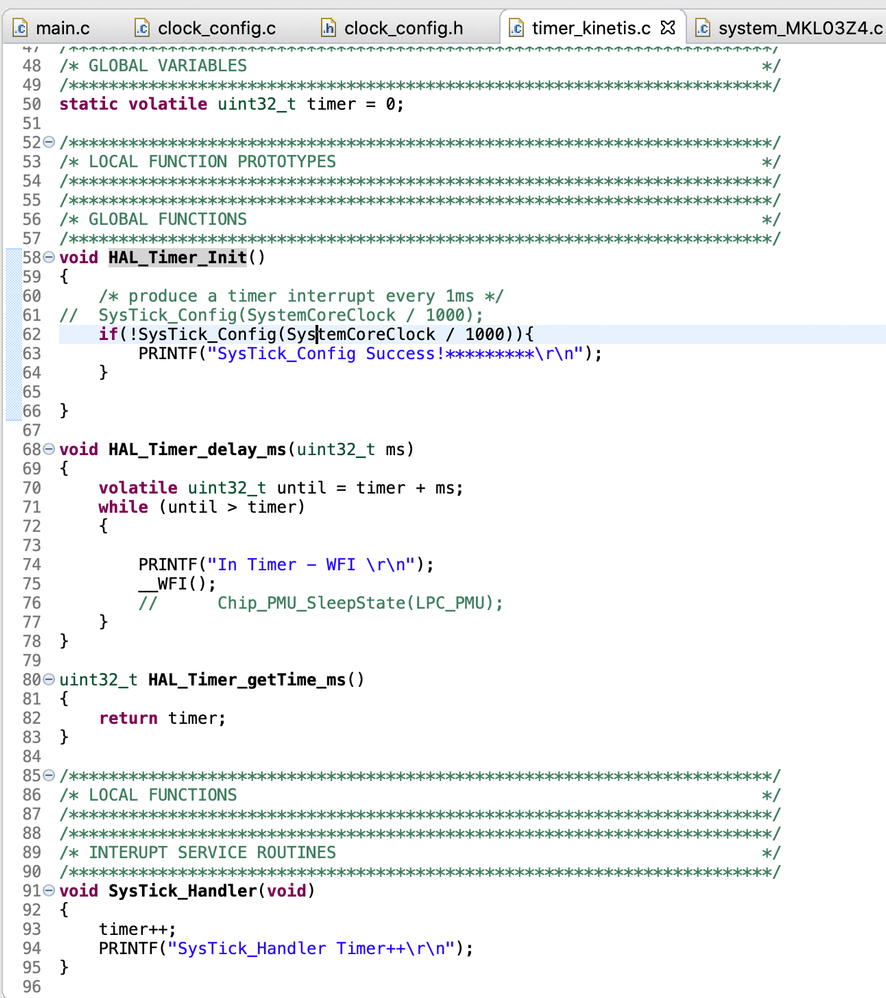

Here is the timer_kinetis code I imported from FRDM MKL02 board, because the MKL03 board didn't come with a timer. It works on the FRDM MKL03 board (!!) but not on my board.
I have left all the parameters default from the freshly download MKL03Z32CAF4 SDK from online and use the Config tool to set my pins and clock. I feel like I am missing something obvious but I don't know enough to make changes on my own.

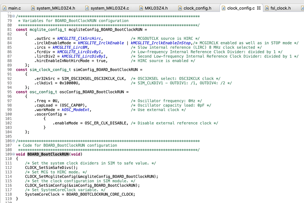

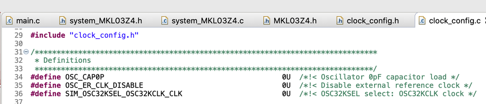

It looks like I misunderstood what you were saying. What I showed does confirm that the SysTick is using the same clock as the Cortex M0+ core. So next step is to find out how the Cortex M0+ core clock is set.
I attached the screenshots of how MCUXpresso Config Tool setup my clock:Screen Shot 2020-05-12 at 12.50.11 PM.png
I told the config tool to disable the external clock and use the internal HIRC source. I assume that is what it is doing here. Is there something else I need to change?

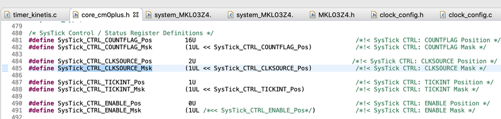

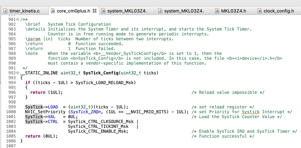

I dug into the SysTick_Config that initiates the timer because it must reference a clock in it somewhere. I found that there is a value set called SysTick_CTRL_CLKSOURCE_Msk and when I followed it is just a single bit that is currently turned on at bit 2 of the address you mentioned (0xe000e010). I couldn't find any documentation on it from what the options where so I have not tried changing it yet. But based on your comment, I assume then that on (1) must refer to an external reference clock, and therefore if I turn it off (0) that should set that reference to the core clock. Is that correct?
I attached my screenshots of the SysTick_Config function:
And the SysTick_CTRL_CLKSOURCE_Msk variable:
