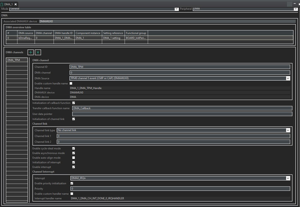

Hi everybody.
I'm using the FRDM-KL46z with MCUXpresso and I want to control a NEO-Pixel LED but I need to use the TPM and DMA.
I configure the DMA with config-tools as follow.
pastedImage_1.png  And the TPM is the same and as follow.

Hello Abraham Rosas
Checking your configuration I noted that the TPM interruption is not set. Please try checking these boxes.
If the interruption is not set then the DMA will not know if the TPM has overflowed.
Let me know if this helps.
