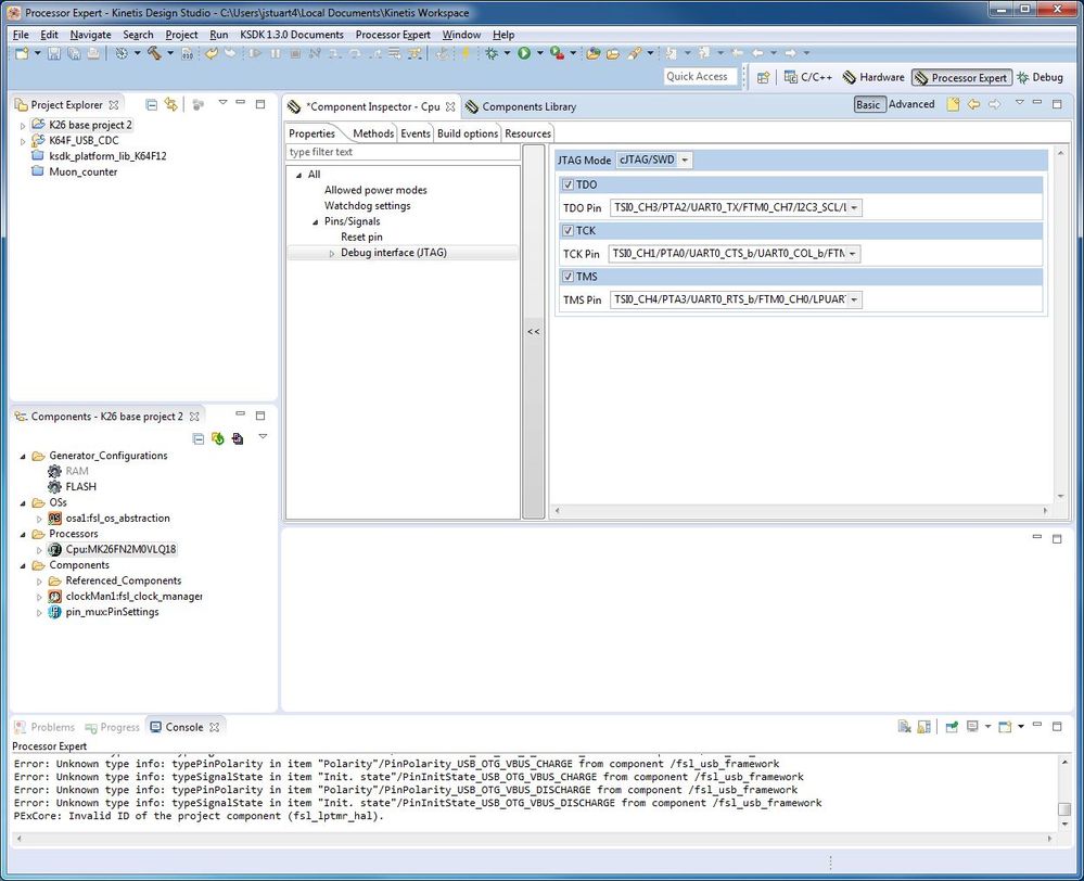

The KQRUG shows that PA0 through PA3 are needed as well as reset, but I have also seen schematics using only PA0, PA3 and reset.
Can anyone say what I should use for a K26 board and are there any differences in debug capability with more or less pins?

This MCU supports SWD and JTAG debug interfaces. SWD needs only DIO and CLK lines while JTAG needs TMS, TCLK, TDO, TDI and RESET_b lines.
I recommend you to take a look into this document from ARM where the differences between SWD and JTAG are explained.

therealfreegeek
Hi Robin,

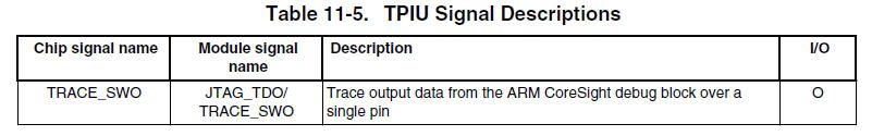

Thanks for the link, in the image below you can see that I have selected SWD mode in the CPU component but it seems to also suggest to use the TRACE_SWO line on PTA2. Can you explain what this is and why it should be used?

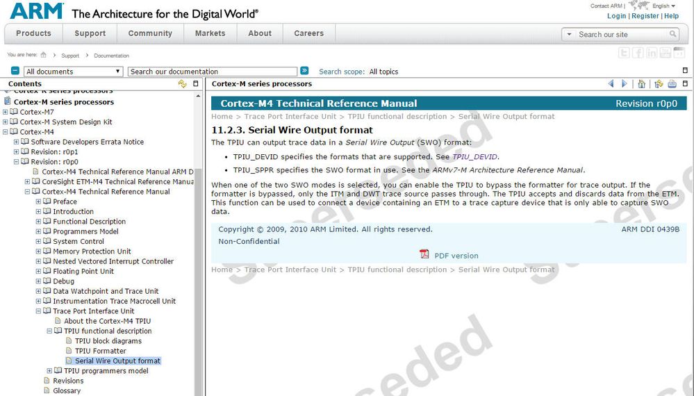

You can also read the 11.2.3. Serial Wire Output format if you want to use this function.
