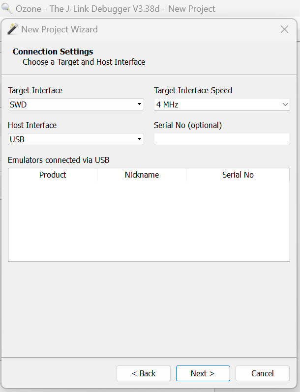

vediyappan_villali
Hi NXP Team, Could you please suggest us the solution for the problem - FRD-MKE17Z512VLL9 development board is not getting detected in the Ozone J-Link debugger?

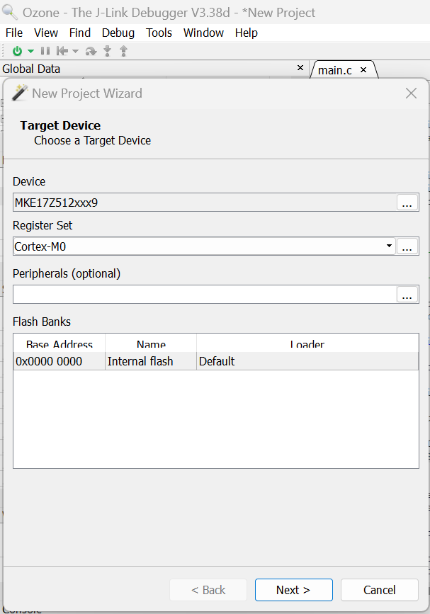

vediyappan_villali
@_Leo_  Thank you for the details.
Now, we are using the MKE17Z512VLL9 evaluation board for our PoC. But it it not detecting in Ozone J-Link debugger. Please find the attached snapshots. Please find the attached snapshots.
We tried to resolve this issue by following steps provided in https://www.segger.com/products/debug-probes/j-link/models/other-j-links/opensda-sda-v2/. But, when we connect MKE17Z512VLL9 evaluation board to the PC via USB while keeping the reset button of the board pushed, it is not starting the OpenSDA platform in MSD mode. The OpenSDA platform is not show up as mass storage device (MSD) on the PC just like an USB stick. To be informed, the similar issue we found in MKE15Z256VLL7 evaluation board, but we were able to resolve the issue by following the steps mentioned in the above link.
Please guide us - how can we make the MKE17Z512VLL9 board is getting detected on the Ozone J-Link debugger?
