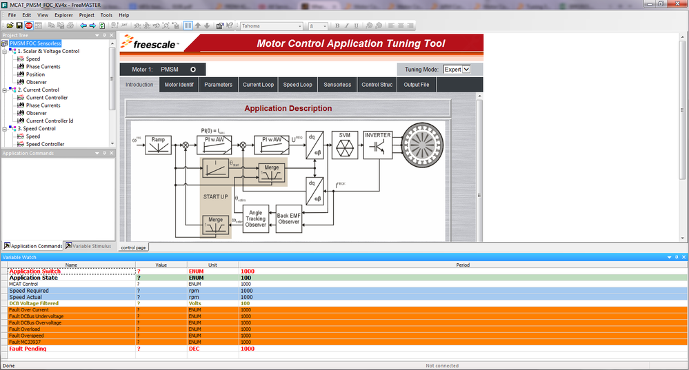

Is MCAT a separate download from Freemaster?  I have Freemaster but don't see MCAT.  Where do I get the Plug-in?

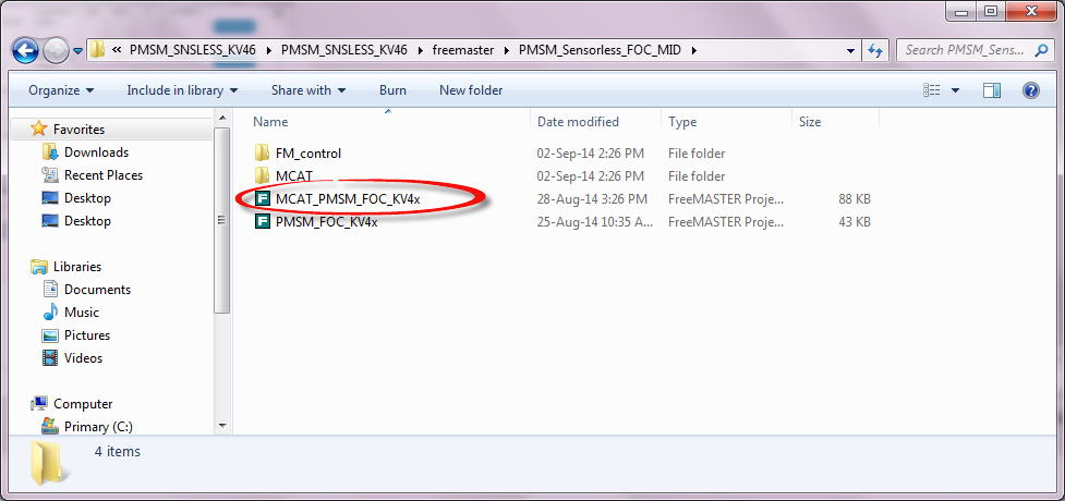

Hi aworthi,
MCAT is supplied with each demo created for the customer.
if you go to Motor Control Application Tuning (MCAT) Tool|Freescale tab Documentation, All Documentation
and download some Application Note (AN) with the software (zip icon under "Download" in the screen below)
you can try MCAT in these demos. It is always included in the demo folder.
You can test it, change the values, follow the trends as you want.
You can also look at the video at Motor Control Application Tuning (MCAT) Tool - Introduction
