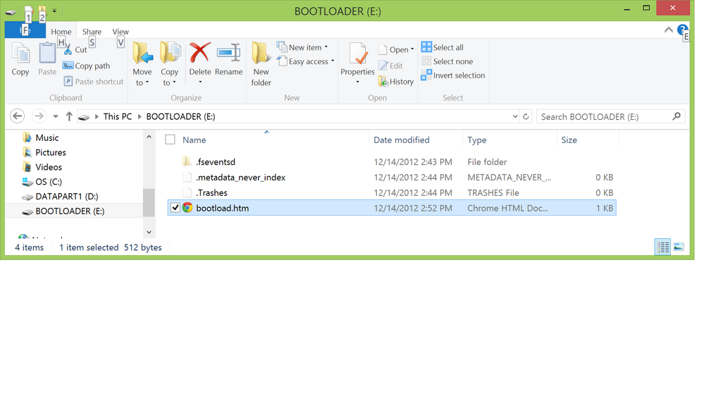

I have my TWR-K24F120M board in bootloader mode, there are no useful files on it, the htm is a broken link to mbed.org.  Where is the openSDA file for the K24 that I need to download to be able to debug from KDS?
Ian

Hi Ian,
This is a board with OpenSDA v2.1 firmware on it.
You can debug it either with a P&E or Segger (Segger J-Link Firmware for OpenSDAv2 | MCU on Eclipse) connection (instructions shown for FRDM-K64F, but very similar for the TWR-K24F120M).
The Segger firmware is available from SEGGER - The Embedded Experts - OpenSDA / OpenSDA V2: make sure you use the V2.1 firmware!
For P&E, if you are using Kinetis Design Studio V2.0.0, then the P&E OpenSDA firmware file is in
C:\Freescale\KDS_2.0.0\pemicro\opensda\DEBUG-TWR-K24F120M_Pemicro_v108b_for_OpenSDA_v2.1.bin
I recommend to upgrade to v2.0.0 (see Kinetis Design Studio V2.0.0 available on the Web!).
Otherwise you can download the firmware files (Firmware Aps) from the P&E website (P&E Microcomputer Systems).
See as well OpenSDAv2
I hope this helps,
Erich
