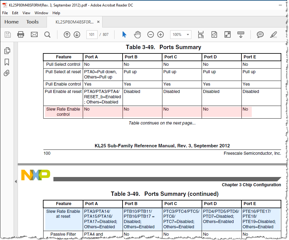

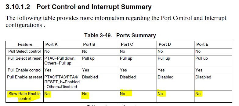

The "Table 3-49. Ports Summary" of KL25P80M48SF0RM shows you can not control the Slew Rate. The default Slew Rate configuration are listed in that table, most of the common GPIO are default configured with Slow Slew Rate.

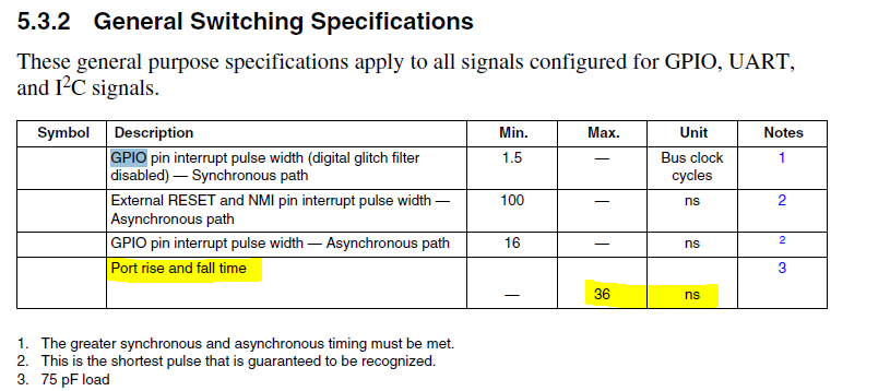

The Slow Slew Rate can be found in "Table 14. General switching specifications" of KL25P80M48SF0.

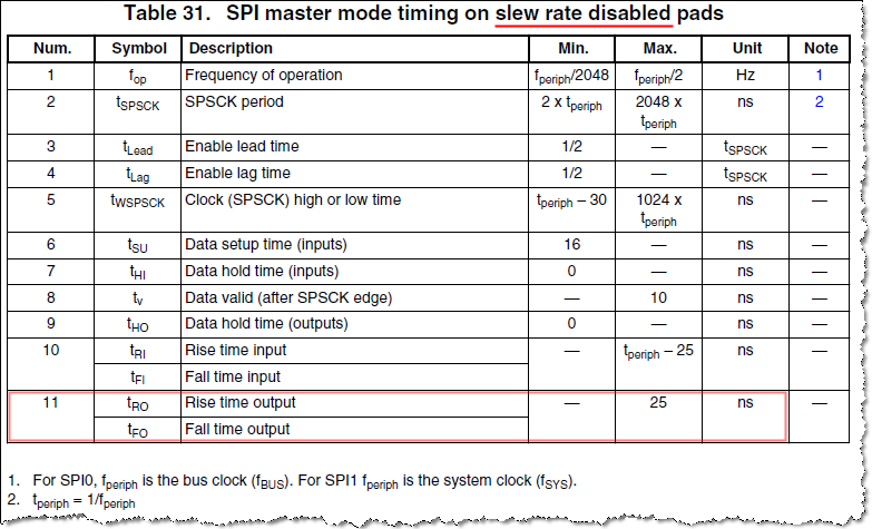

For other individually Fast Slew Rate you need to search "fall time" in KL25P80M48SF0. For example:

Therefore no control possibility on the KL25.

Thanks Mark - saw this table, but was confused by the next line "
And by bit 2 in the Portx_PCRn register:
And 11.2.1 which says
   Individual slew rate field supporting fast and slow slew rates on selected pins.
Seems very odd to include all that in the documentation if there is no ability to actually adjust the slew rate....
And also, really would like to know the minimum rise and fall times. 35ns for the maximum is fairly high. We're trying to diagnose an issue with electromagnetic noise on a board, and the rise and fall times can be a contributor. We were hoping to work it out through the documentation, but will measure it. And then if it is an issue, we were hopeful that we could adjust the slew rate to slow to correct it.
