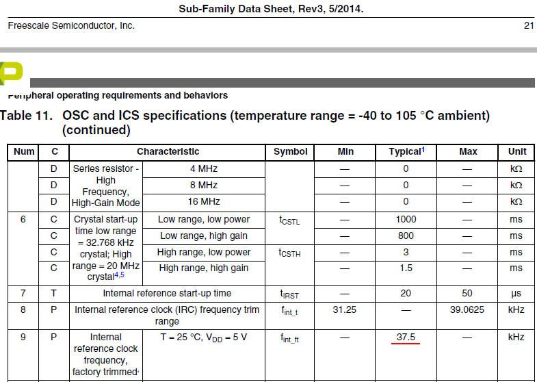

From the datasheet MKE04P80M48SF0 we can find the factory trimmed frequency of Internal reference clock is 37.5kHz.

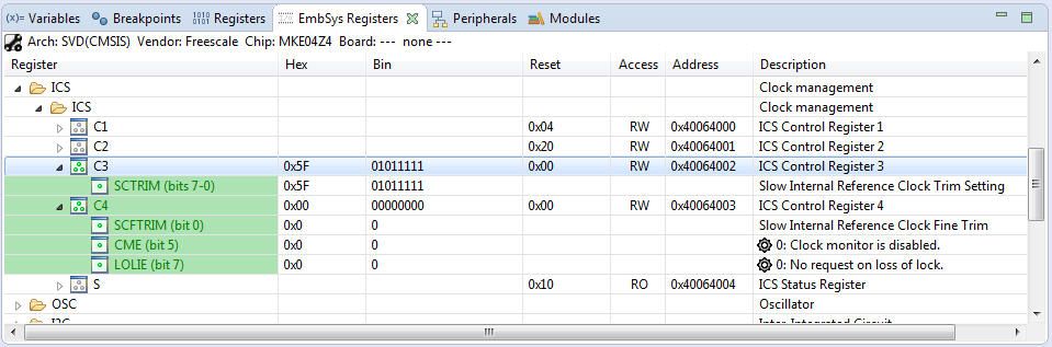

And I can get this value during debug mode. I am using KDS3.2 with Processor Expert.

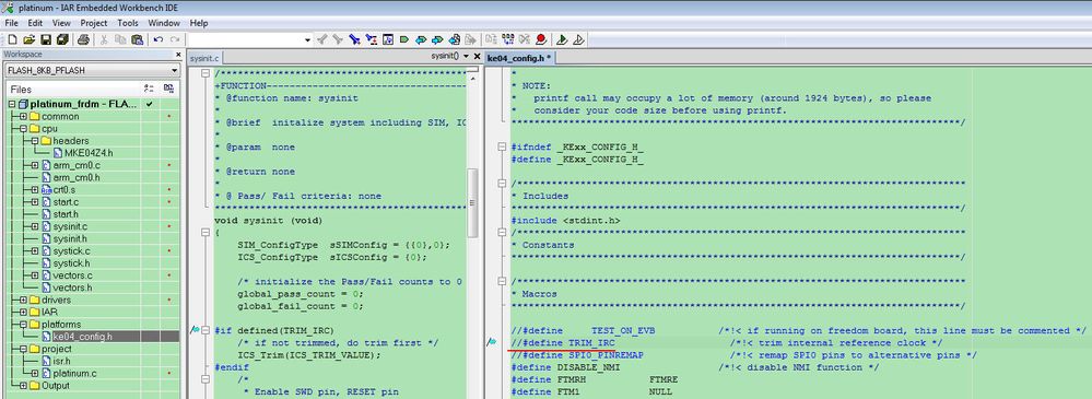

If you are using the project in FRDM-KEXX Driver Library Package (REV 1.2.1), pay attention to the wrong ICS_TRIM_VALUE. You need comment the #define TRIM_IRC in ke04_config.h when using the default 37.5kHz IRC.

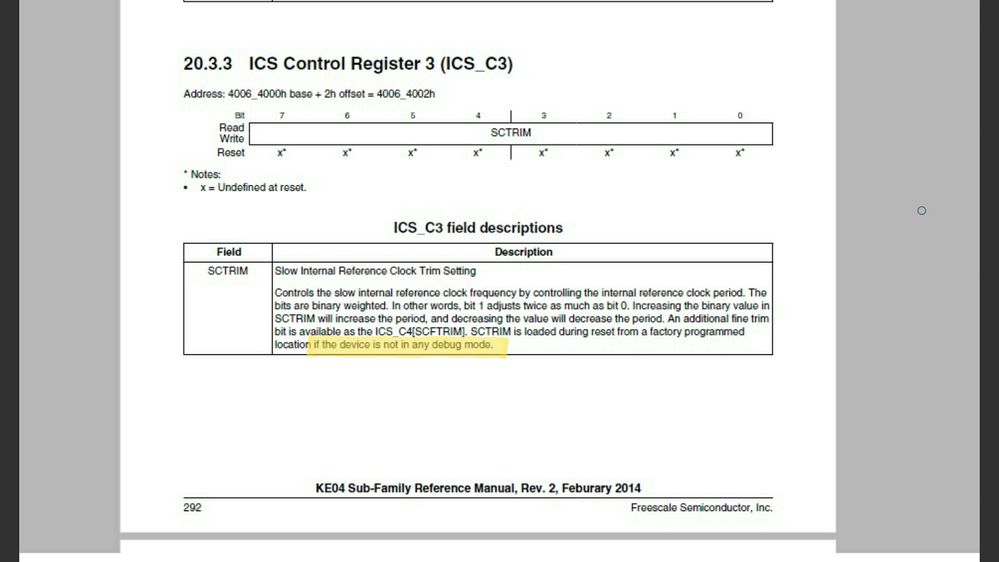

Thank you very much for the time you spent for your answer. Unfortunately it doesn't answer to my question, because in the reference manual MKE04P80M48SF0RM , you can find thatScreenshot_2016-04-06-10-41-12.jpg

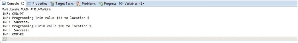

I discovered the problem because I used PTH2 to monitor the bus clock frequency. I use CodeWarrior 10.6 with PEMicro Multilink Universal. I noticed that the Multilink Universal wrote the trim value and if I run my software not in Debug Mode everything is ok. I searched for the location where Multilink write the values, but there's no address.
As you can see Multilink write 0x53 to TRIM location (not mentioned).
I stolen the 0x53 value and manually I put it into ICS_C3 and it works fine, but is not the correct way to solve the problem. I would like to generalize so if I change board I don't have problem and I don't have to search for the value.
