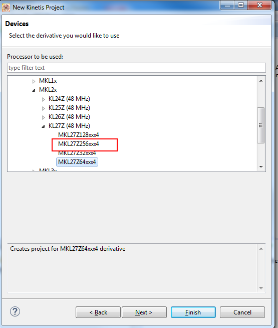

Hello BOB,
when create project on KDS, select the chip of MKL27Z256, there will be the header files about this chip.
Hope it helps
Alice
889件の閲覧回数
Hello Bob,
Please check the part number of your chip ,
on the KDS+KSDK, for the different chip there is the corresponding header file  :
MKL27Z644.h  MKL27Z1284.h  ....
So please be sure your chip .
Hope it helps
Alice
