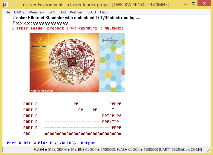

!Hi All
I have attached binaries for the TWR-KW21D256 and TWR-KW24D512s which are built for KBOOT UART (57'600Baud) on the Virtual COM interface. A second one for the TWR-KW24D512 also includes KBOOT USB and USB-MSD composite. The application address is 0x8000 for the UART alone ones (0x8080 for the one with USB-MSD) and the application size if limited to 96k.
However, the code hasn't been tested on the HW - only simulated in the uTasker KW simulator (which hasn't been fully verified yet).
The UART only ones use the defaut clocking (20.9715MHz) for best chances of operation (the RF modem is held in reset). Due to the USB requirement, the one with USB uses the RF Modem's CLK_OUT as reference and 48MHz PLL operation. This configuration is more likely to fail since the setup was performed from the manual's description alone and is completely new.
When successfully operating the blue LED (D5) will blink at 5Hz. To force the loader mode, hold down SW1 at reset.
Since I am travelling for several weeks (with a load of boards for support work but no KWs, since further development was planned for in September) I will not test the operation on HW until after return. In case any one does test and finds that there is a problem just contact me for complete code (builds with CW, KDS, IAR, Keil, Greenhills, Atollic, Rowley Crosworks and CooCox as well as VS based simultor) since it should be quite simple to solve any remaining issue (there is not that much different in a KW to a typical K series device).
There is a screen shot of the simulator in operation below - if the binary does work it will of course be a good advertisement for the simulator ;-)
Mark
